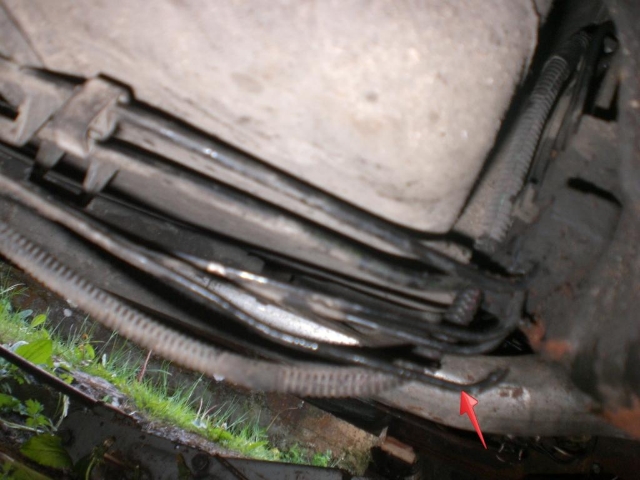

My Xantia's rear plumbing
A sunny day today so I have been under the Xantia attempting to follow the complicated plumbing. In conclusion there are only two possibilities for the leak, the return 3.5mm metal pipe from the height corrector ( not the plastic one) , or my original thought the number 9 3.5mm brake supply pipe. The return pipe wouldn't gush and spurt would it?
This is the end result
regards

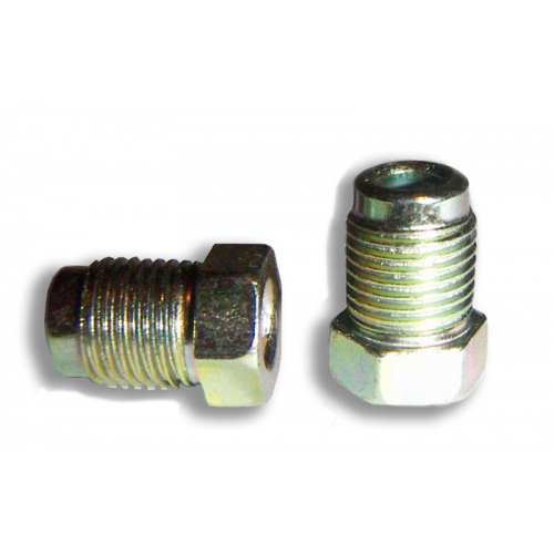

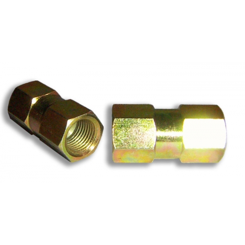

and some 3.5 pipe which Martin at Pleiades will sell yousuperloopy wrote:
The connectors are M8 x 1.25 and i've got some of those complete with pipe seals lying around so i think all you need would be a couple of joiners.

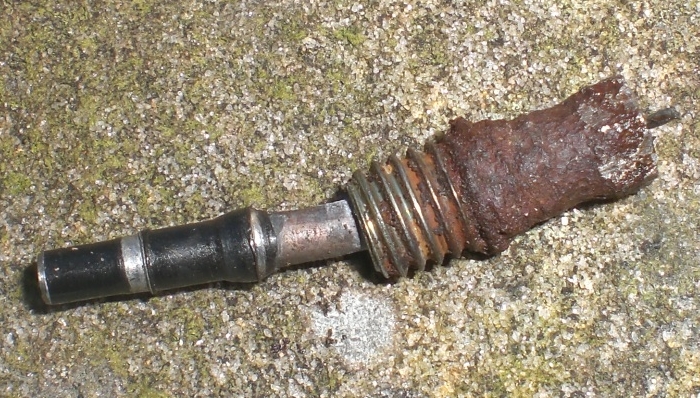

Sawed off the No9 pipe at the offside K connector. Selected a hex 8mm socket-too big, 7mm hex socket next-just too small so hammered it on. When I say hammered-its impossible to get a hammer anywhere near as hammering room is very restricted. Used the extension rod from the socket set as a hammer and on it went.
Next problem-plenty of grip with the 7mm socket but minimal room to move the handle. Detaching the K connector gave a little extra room but the body of the K connector needed gripping with mole grips to brace it against the turning force of the socket and ratchet.
Think I got it out ok without damaging the other pipes in the offside K connector.
I presume this connection has a rubber seal but it certainly didn't come out with the union. Maybe its still in the K connector haven't looked yet.

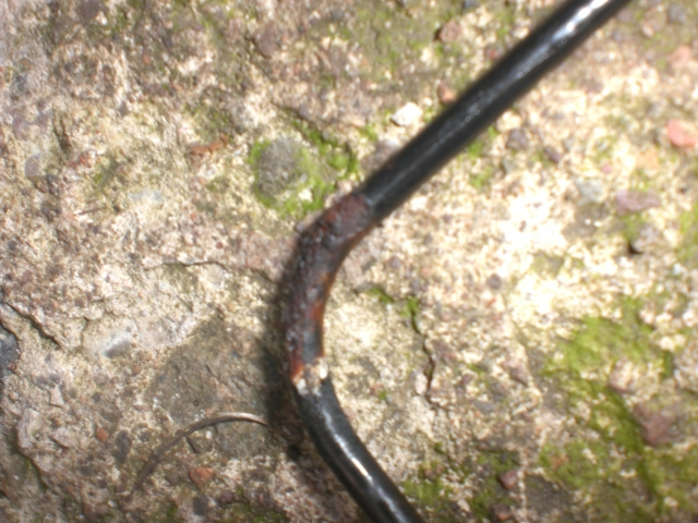

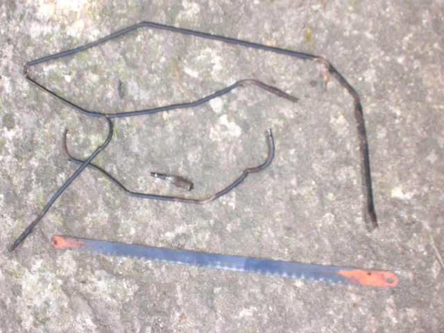

Prised out the pipes from the clips under the nearside where they approach the rear subframe in a straight run and sawed off the no9 pipe at this point.
Tried to remove the No 9 pipe in one piece, didnt succeed.
All the tight bends were very corroded, and had the offside section not given way the nearside bends would have been not far behind.
Next stage having a bit play with Mike's tool if you pardon my French, to try to get a decent flare on the steel pipe I have cut under the body at the nearside.
regards Neil

Ordered a couple of female/female joiners from Martin at Pleiades today but in the meantime tried the tool out on bit of steel brake pipe.
Not the finest or biggest of flares, but has a good chance of doing the job. Thinking about connectors I dug out this bank of 4, which I had salvaged from my old xantia.
I could saw one off to get the job done but I am in no rush so will wait for the shiny new ones to arrive.
regards
