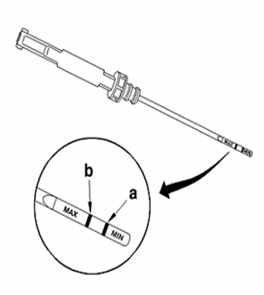

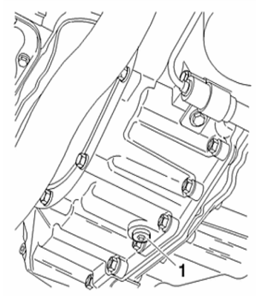

HP20 Gearbox Oil Change:
Drain
ESSENTIAL: The gearbox must be drained when the oil is hot ( 80 °C minimum), to eliminate the impurities suspended in the oil.
N.B.: The oil change is partial, since the converter cannot be totally drained.
Remove:
Engine flywheel retaining pin (1).
Filling is through the dipstick tube.
Use a funnel with a very fine filter (mesh of 0,15 mm maximum).
ESSENTIAL: Do not fill with fluid other than the recommended fluid.
Refit the oil dipstick.
Oil Level Check
Prior conditions:
ESSENTIAL: The fluid level must never be above the max mark .
Too high a fluid level can cause:
Drain
Remove:
- Oil dipstick
- The drain plug (1)
| Total oil capacity | 7,7 litres (minimum). 8,3 litres (max.) |
| Oil remaining after draining | 4,7 litres (minimum). 5,3 litres (max.) |
| Quantity of oil to be replaced | 3 litres (approx.) |
Oil Level Check
Prior conditions:
- Vehicle on a level surface
- Hot oil (minimum 80 °C)
- Apply the brakes firmly and move the lever through the various selector positions
- Selector lever in position "P"
- Engine running
- Overheating of the fluid
- Fluid leaks
