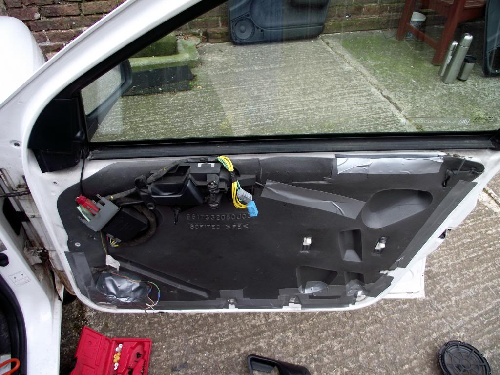

I have sealed up three of the four membranes now, just need to remove the rear door panel I fitted last week to check that one is ok.

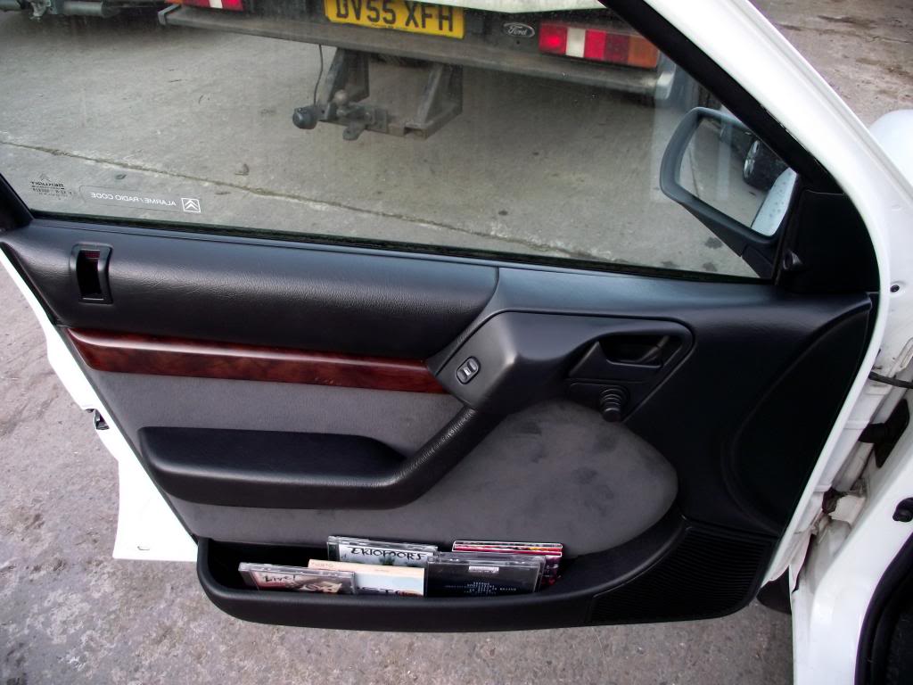

Inner front membrane reinstated:
Front 'hybrid' door panels fitted

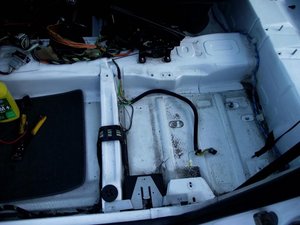

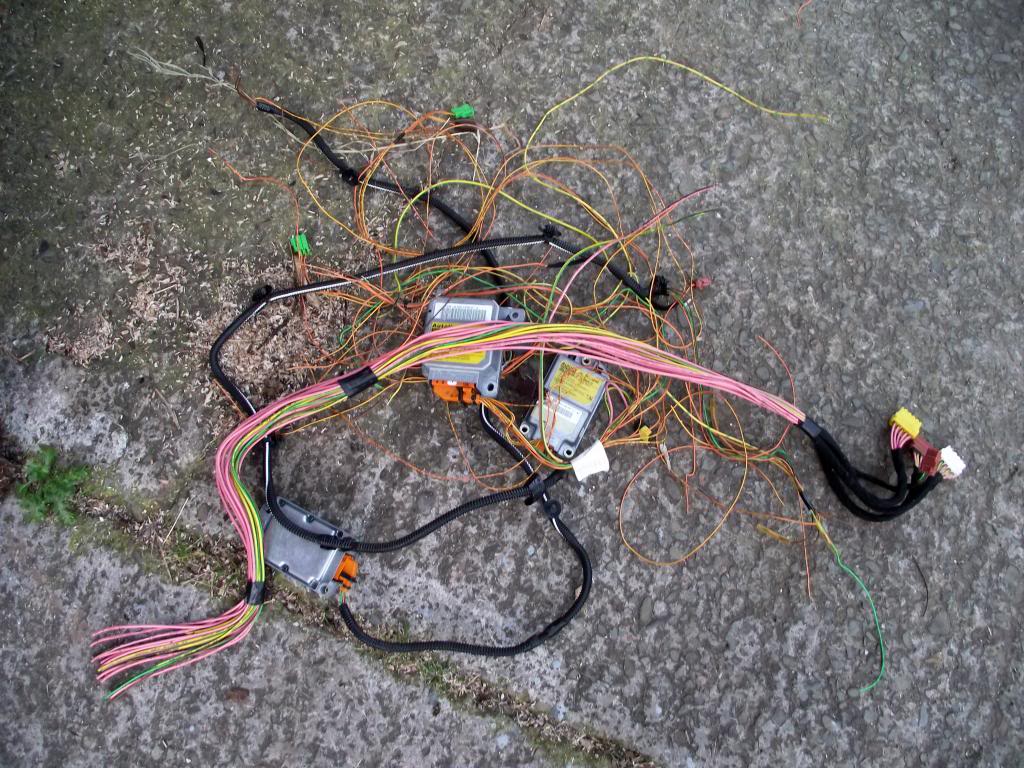

Wiring loom was modified to loose the airbag wiring that I don't need:
Wiring loom laid (passenger side shown):

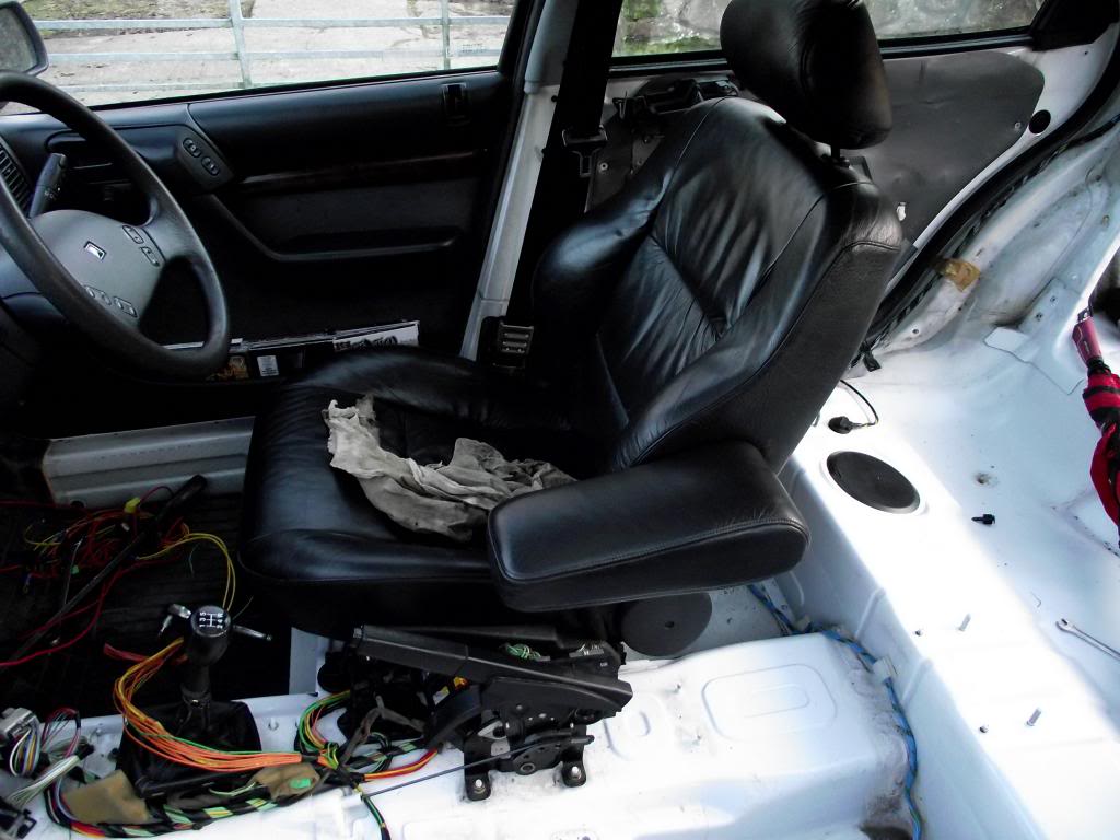

'New' driver's side seat fitted:

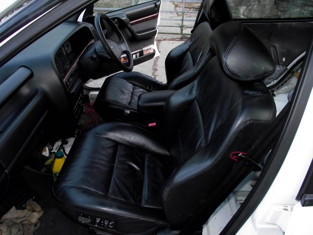

Both front seats fitted:
I tried the seat heaters on the way home. Not sure if they work or not. The driver's side possibly, couldn't seem to get anything from the passenger side though.

Looks like you have a Side Air Bag ECU there which I think HellRazor is looking for??
Prehaps send him a pic of the removed air bag stuff and ask him??

If you don't need the side airbag ECUs, I could do with one for Gracie. According to a Lexia session at CitroJims' the NS ECU isn't talking.

Funilly enough I was going to advertise them on here and ebay (on the next free listing day
) as I don't need them. I have both units that mount in the door pillars and the one that mounts in the centre consul under the coin tray. PM me and we'll sort something out if you need one.

Well the good news is that both seat heaters work. They take a while to warm up but both get hot.
