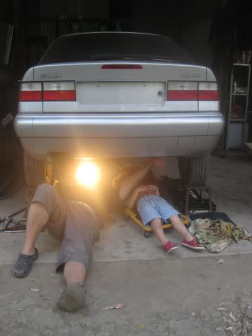

Did the orange fitting (LHS) today and i think i'm going to make a tool to hold the hose to make it easer to plug them in. but as told by every one i should have waited till i could get both. broke the blue (RHS) in the process.
here is the apprentice pointing out the new leak.

Excellent news Sam
I see your halo is shining brightly in the picture above

My wife did take a photo when i was bent over inspecting the front end but the brightness of the sun shining out of my a$$ was to bright to make any thing out at all.CitroJim wrote:I see your halo is shining brightly in the picture above![]()
