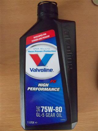

I've found some Valvoline HP PC Gear Oil 75W80 on Eurocarparts website, which suggests it's for Citroen/Peugeot applications, although doesn't say it's BV compatible:
http://www.eurocarparts.com/ecp/p/car-a ... &1&cc5_868
If I enter the "midmonth30" code at the checkout it means I can currently buy 2 litres for £11.24 inc. VAT.

That's the stuff Dan
Order it quick!!!

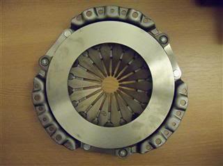

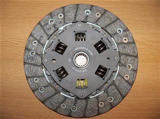

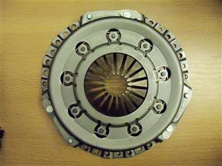

In today's post I received a LUK RepSet Clutch kit comprising of a Friction Plate, Pressure Plate and a Release Bearing (£78.63), a pair of Gearbox Driveshaft Oil seals (£8.89) plus a pair of Fork Lever Bearings (£7.49).
UPDATE: Now got the Guide Bush/Primary Shaft Seal (£7.95), waiting for the transmission fluid to arrive.

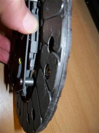

What took me by surprise was how thin the friction plate material is, should it really look like a barely legal brake pad? Also, the yellow spring in the photo appears really flimsy, is that normal?
The clutch kit did not come with any grease, am I looking for high temperature stuff like lithium grease?

Re: Xsara BE3 Clutch Trouble
Perfectly normal

Thank you flying clutchman,
It was a very daft question, but it's the first time I've seen one up close
Quite amazing to think that all of the engine's power is being transferred via that skinny friction plate.

- Posts: 12596
- x 1489
And it you haven't been abusing it you may well find that the plate that's in there doesn't look much different!

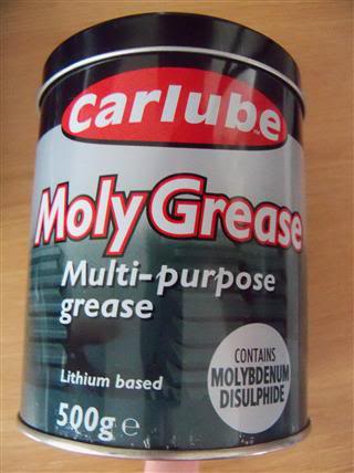

Picked up some "MolyGrease" from GSF, hopefully this contains enough Molybdenum Disulphide (it's largely lithium based) to be good for use on the clutch parts.
A very thin smear I will add....

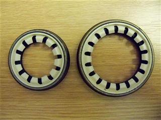

EDIT: Quick silly question about the driveshaft seals, do I leave the plastic protection teeth in place after the driveshaft is fitted (see above in previous post)?

dandare1980 wrote: EDIT: Quick silly question about the driveshaft seals, do I leave the plastic protection teeth in place after the driveshaft is fitted
yes they stay there
