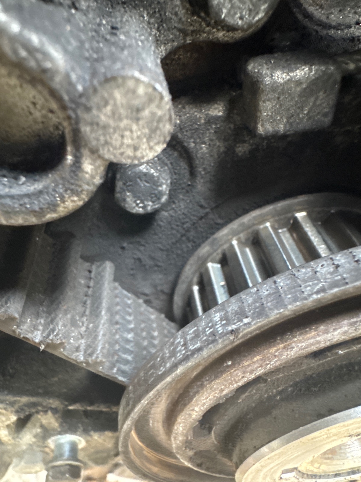

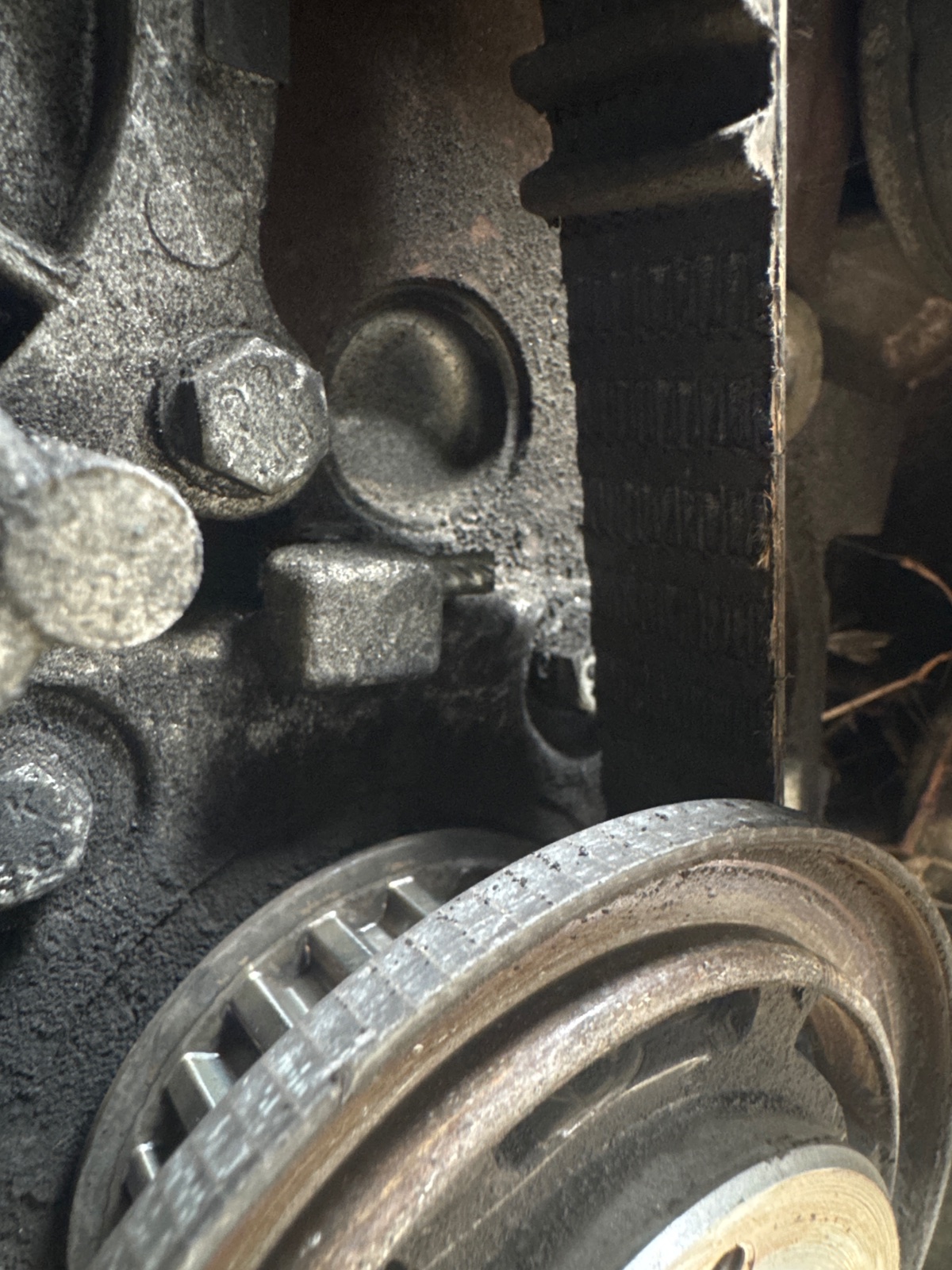

My 4007 2.2 hdi just cut off while driving cam signal - signal missing is the diagnostic code so expected belt snapped was planning to change it next week I have a week off work, but when I turn the key the belt rotates 2 revolutions then stops rotating while engine is still cranking I can hear compression and belt isn’t snapped I guess it hasn’t interfered and smashed itself it cranks fine, could it be the rubber /plastic crank pully slipping? I’m going to start stripping the side of the engine before work tomorrow and continue after work until my neighbours shout at me but any ideas etc I can’t sleep I need the car fixed asap I have the new belt kit and water pump ready to fit should I order a pully/ key way ready for when I get it all off or you think engine is smashed? Thank you in advance!!

The cam belt isn't driven by the crank pulley, it's driven by a metal sprocket behind that.
Your symptoms sound like it might that your tensioner has failed and the belt has lost tension?
Or perhaps the water pump has seized and stripped some teeth off the belt.
Only way to tell is to strip it down and investigate...

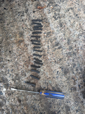

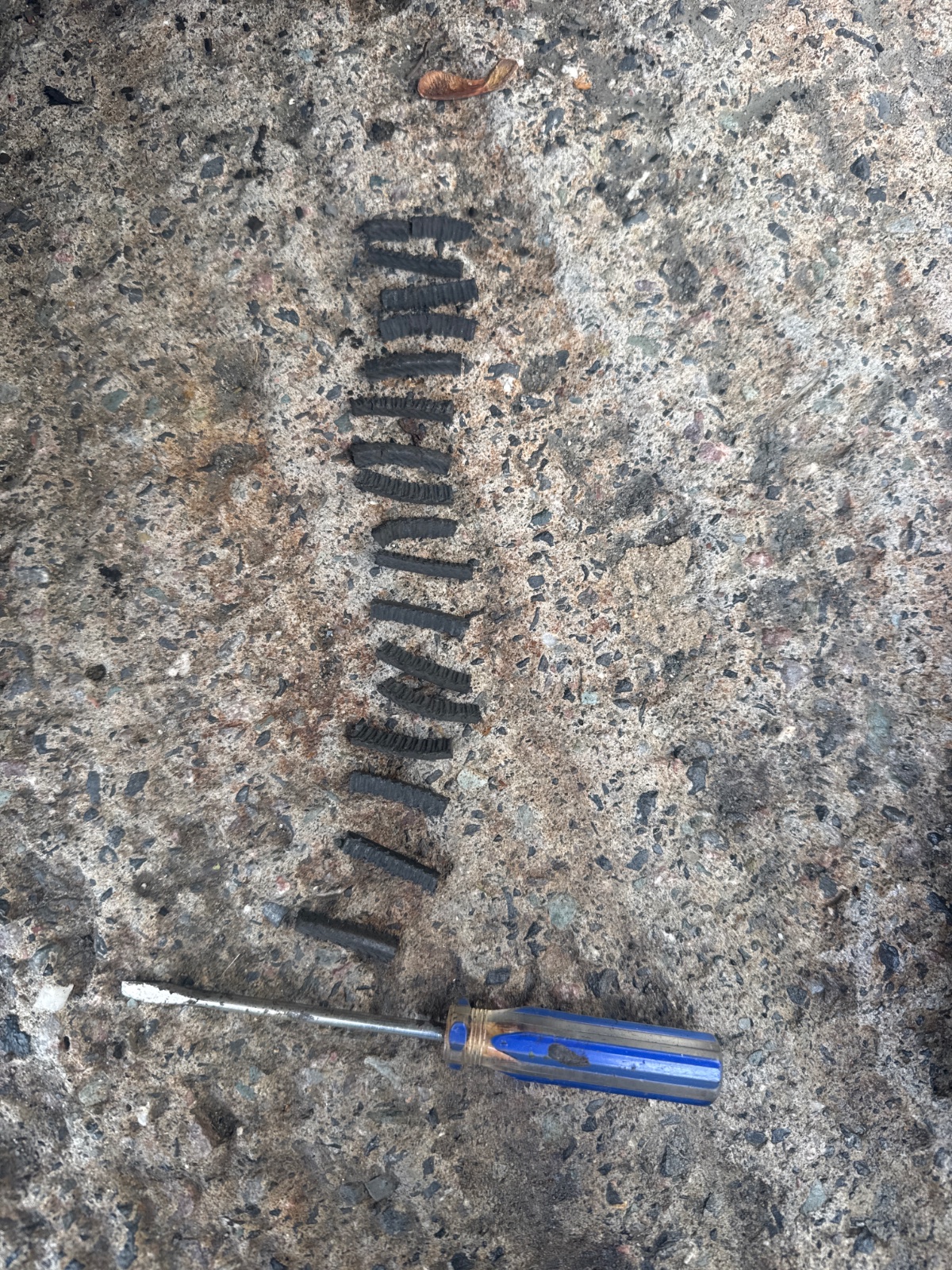

It’s stripped 17 teeth off the belt around the bottom pully so bottom was still spinning while shutting down but top would have stopped or could compression keep the valves moving correctly to avoid smashed valves etc?

I attach a few photos first one is back of engine, 2nd is front of engine and 3rd is the line of teeth that fell on floor when removing the cover,

Ouch.
Well, you know what the problem is at least.
With where you're at, you have nothing to lose by replacing the belt/water pump/tensioner pulleys and giving it a go.
Unless you can see a fault with the bottom pulley, don't go replacing it imo (and that can always be done later without disturbing the timing belt anyway?).
I guess your biggest problem now that it is definitely out of time due to stripped belt, is making sure you have the engine correctly timed (top at the correct TDC in relation to the bottom)...
