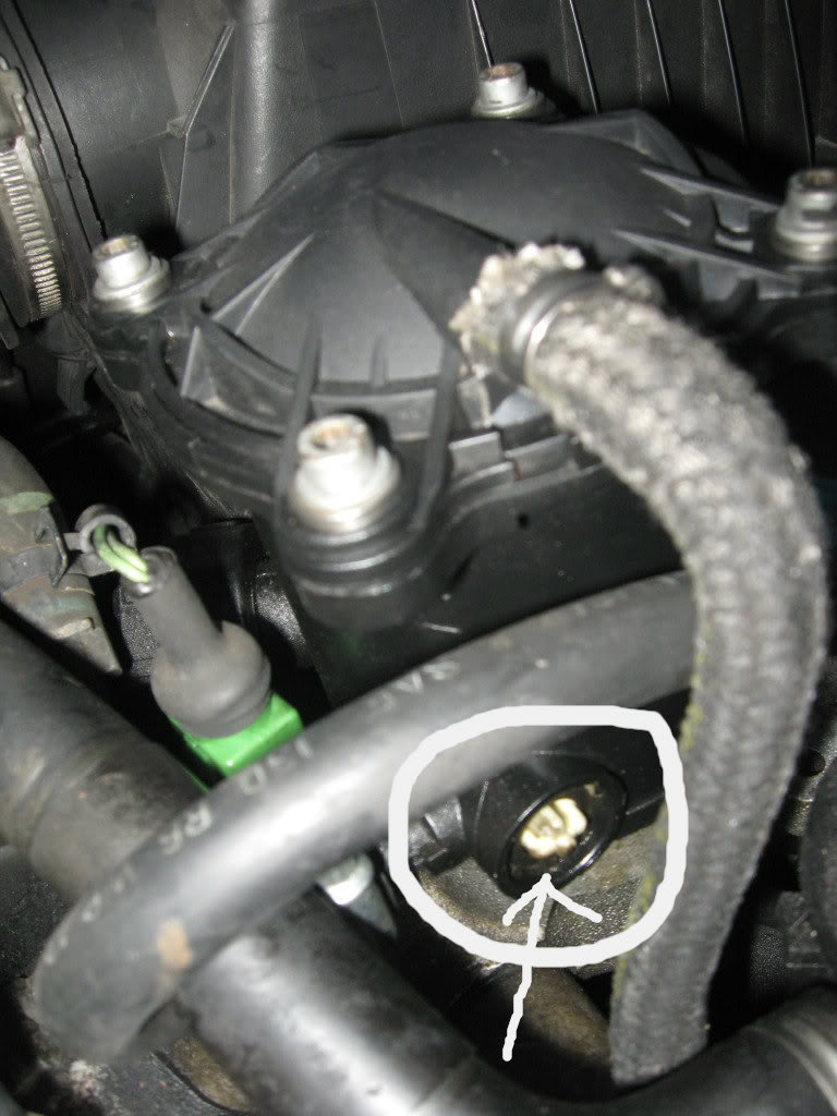

Anyway i think i've got to the bottom of the air ingression fault. Both Neil on the BX forum and 'citroenxm' here said fuel filter. Correct.
But the bit thats leaking isnt labeled on any diagrams so stand by whilst i try to upload my photo. (no its not the water drain off things its 90 degrees to the left facing the engine block....)
as the arrow indicates it actually flows out from the bottom of this 'circular thing'.
Please dont tell me that diesel is meant to come out of here! i'm getting rather bored of the extended starting sessions...
Thanks
Phil
Thanks
Phil

That's the fuel heater thermostat Phil and a very common place for the filter housings to leak!
Basically, it's a device that allows the fuel to circulate a labyrinth in the thermostat housing to warm cold diesel.
The leak is caused by a duff O ring on the end of the white bit but as it's held in place with a star washer it's excruciatingly difficult to get it apart satisfactorily and effect a good repair.
Either swap the filter housing for a good 'un or remove yours and clean it up very thoroughly and cover the white bit and the surrounding area in Araldite for a temporary/getting on for permanent repair. The critical bit is to get all traces of diesel away or the Araldite won't stick properly.

thanks very much jim as always helpful bordering on saintly! I was going to ask for help changing the filter...
After to say whislt it may be common its difficult to see (due to pipes) and causes such difficulties especially in cold weather...anyway ill phone the garage and see how much to fix it.
Hate to be cheeky (but for added bonus points!!) How much should it cost? (down at the garage)
Many many thanks
Phil

Pass I'm afraid Phil. I never use garages except for MOT tests...PhilGreaves wrote: Hate to be cheeky (but for added bonus points!!) How much should it cost? (down at the garage)
Trouble is, a garage will want to replace it rather than play around with Araldite unless they're a traditional old-school place,,,
The filter is easy to remove. Slip off the top, remove element, drain, disconnect inlet pipe at bottom and then undo the 13mm bolt visible in the bottom and off it comes. There's a big O ring to seal the base of the filter to the thermostat housing...

He says he may have a good one in in stock which would be cheaper as its only a few bolts to swap them over. Could ask for a repair. But if he offers this cheap then may just take that. (in the past he's actually offered parts free)
He is "traditional old-school place" but when you are paying labour (and its alot) by the hour most of them time its more cost effective to go new rather than fix old ones. Unless parts arent available (see my bx airfilter housing!!). But ill mention it to him especially the seal business. He's going to get back to me within the hour anyway. Also, logically, i want the car back asap so again dont fancy waiting around to prat with glue.
Suppose i could be cheeky let him fit the new one and then prat on myself glueing the old one...he he. Then i'd have a back up in case the used second hand one goes in our artic conditions...
Thing is you see BX is sorn'd, dads audi is..well..aside from 22.8mpg runs rough so the xantia is the only car left so im loathed to fiddle with it myself coz if i screw up then my mum cant go to work i cant go anywhere my dad will chunter etc. God i wish she'd buy a new car...but then again why are all new cars crap?!
oh hydraulic leak is minor and coming from acumulator unit, havnet pin pointed this one exactly yet. Havent done anything to it other than go to malcolm lockwods and buy more lhm...And first to second gear is ridiculously stiff first thing in a morning....other than that..LOL..

here is price and part No. for the main part of the filter housing without the lid
Part Number Description Quantity Price excl. VAT Price incl. VAT Total incl. VAT Selection
0000191141 FILTER BOWL 63.49 GBP 76.19 GBP 76.19 GBP
