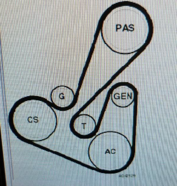

OK - so not what you might call a great success so far.
HELP! Really stuck putting the new aux belt back on. I looked at the the old one, thought I understood the routing and cut it off. Now I can't for the life of me work out how to re-route the new one. It appears to be the same length as the old one, and all the pulleys etc are in place with the tensioner slackened off. Can anyone describe the route for me, or have a pic? non-turbo xud with a/c and pas.

Will this work?

Thanks. It was exactly what I had sketched. My error was not realising there are two! tensioners. One is a manual eccentric tensioner, the other a large spring loaded one. I had only found one and couldn't get the belt to fit. So that bit of the job is done.
