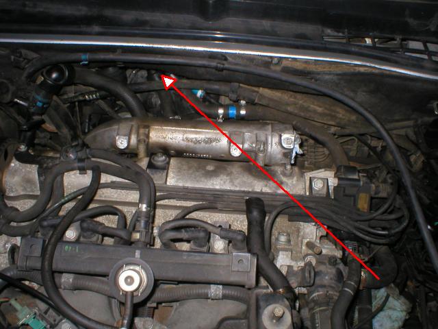

ah sorry after refreshing the page i could see the picture! So first thing i want to do is check the water inlet temperature.Can you please guide me where do i check it?

On a 1.9TD they are hard to see, hiding behind the turbo pipes. On one elbow you'll see (feel) what feels like a tyre valve cap. This is the bleed valve and does the same job as the bleed valve on your central heating radiators does. With the engine running and hot loosen this cap carefully and hot water should issue forth. If there is an air lock then this bleeding will get rid of it. Take care not to loose the cap or scald your fingers. Wear rubber gloves...
Yes, under the bonnet, on the bulkhead behind the turbo pipes look for two pipes running to an elbow connector. This picture shows their position at the end of the arrow. The picture is of an Activa engine but it's in the same place on all Xantias.aneesh84 wrote: Also can you explain where exactly the input line to heater matrix is, so that i can feel the temperature. Or any picture that you can show me for the same. Do i have to go under the bonnet to reach it?

Citrojim, thank you so much! You are right in my TD, it seems almost impossible to reach. But i have located it so now need to somehow open the turbo pipe. Will keep you posted.
