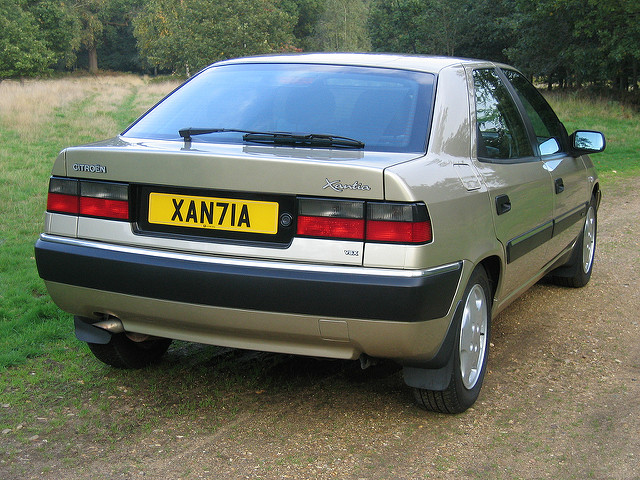

I take it you're going to Little Horwood this weekend, if so make contact and I'll have a look at it although its not easy to see splits until its almost removed, I'll be in XAN71A with a Canon 5D hanging on my shoulders
