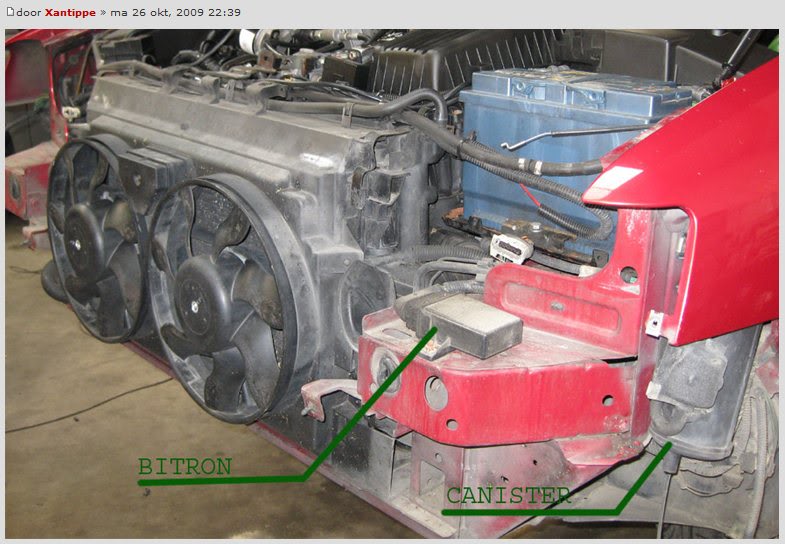

As I said earlier, I don't think it's the caused by Bitron but if you want to give a try ...
I found this pic from a foreign Citroen forum and I copied the pic with the member name :

Unfortunately both Double relay and Air Con Bitron have same manufacturer called Bitron :?
Double relay (fuel, ignition etc) is next to ECU (as you have already found):

Don’t think there’s a fan Bitron on the HDi.
See my post above your last one, you were typing when I posted.
