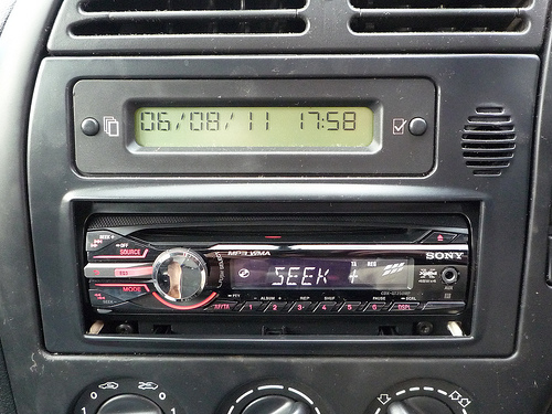

Got my radio installed and I must say I am not impressed at all with the fitment and connnectivity via the wheel.
Firstly, the stereo looks pathetic in the aperature left by the old OEM unit. The gaps are rubbish.
Secondly, for some reason the autoleads PC99-X34 adaptor does not scroll through the pre-programmed radio stations as the original unit did.
Any ideas as to how I can improve the look of this. Totally disappointed in both the aesthetics of the installed unit and the performance of the stalk adaptor.

Get a fascia adapter, most cars require one.

There is no fascia adaptor for this. Autoleads makes one, but it does not fit the LCD display my car has.
Also, just noticed that the stereo is not holding the preset stations as well as not scrolling through them via the steering column.
I think I'll just send the whole lot back and get a Citroen unit.

Any possibility the display can be changed for the 3 button one that there is a fascia for, or would you be able to cut the 3 button fascia to fit your display?

I don't want to change for the 3 button display version as I loose information like Ice Alert, #### Door Open, Boot Open, etc.
I could cut the fascia as you suggest and was thinking of this, but the other issues are too much to suffer. If it cannot hold stations it is worthless to me.
I also have reservations about how well the single din fascia would look as the head unit still will not be a flush fit with the fascia but rather recessed due to the shape of the head unit.

With regards to the holding of stations, I would expect there were two power feeds, one to the battery for keeping settings, and one to the ignition.
I'm sure my xplod had these seperate to the ISO plug.
Could be that both leads are coming off the ignition so it's losing it's settings when you take the key out?
Otherwise there's something faulty with it.

Yip - thanks, that fixed that!Xac wrote:With regards to the holding of stations, I would expect there were two power feeds, one to the battery for keeping settings, and one to the ignition.
Steering wheel adaptor now working too - I think the aux in on the rear was not fully connected. Still looks naff though.
I did find this guy on another forum, but no reply from him so I'm not sure how he done it. I can't see how he managed to get his unit into that position.
