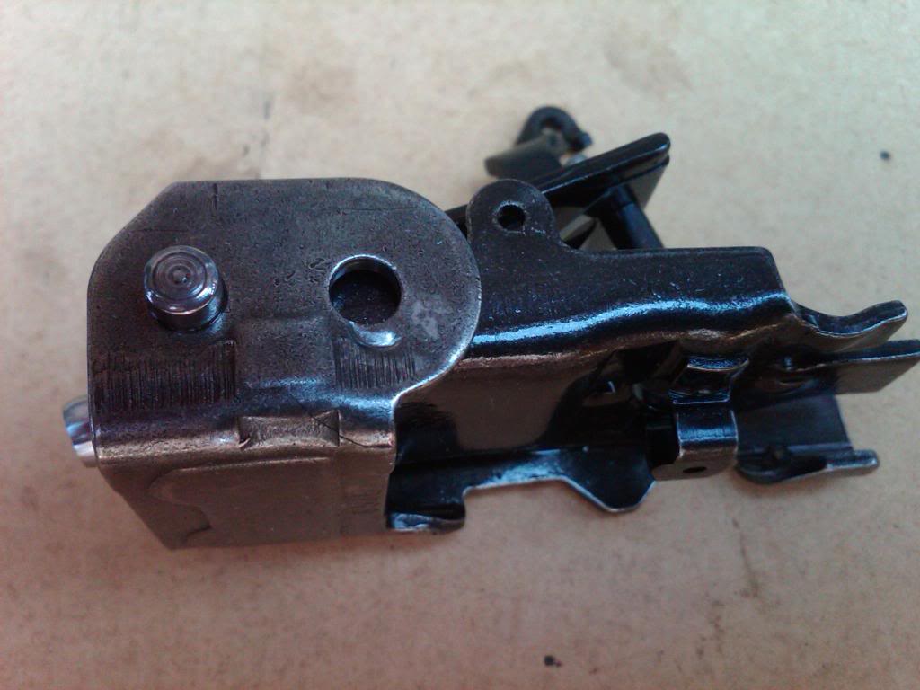

As soon as i took the top of the pump for stripping i tried to push the governor plates they were stiff to say the least,looked at the pivot bolts and yes it had been undone and then done up but not in the hole provided
The material it is made of does not like to be straightened, it groaned as I bent it back to shape and cracked.

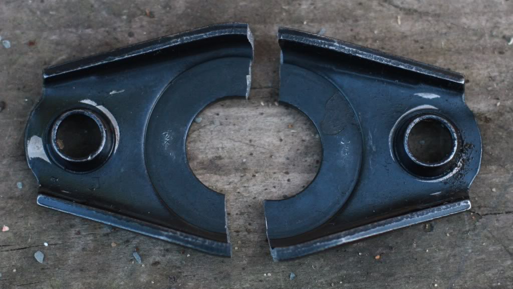

This has i assume caused stress to the plate which holds the two large springs from the distributor and is now in two after i dropped it on the floor that is.
These two smal springs would not fall out when i tipped it up on the bench,
on PULLING them out were half full of what must have been FAT.
So he must have been using chip oil (he was a bit lardy

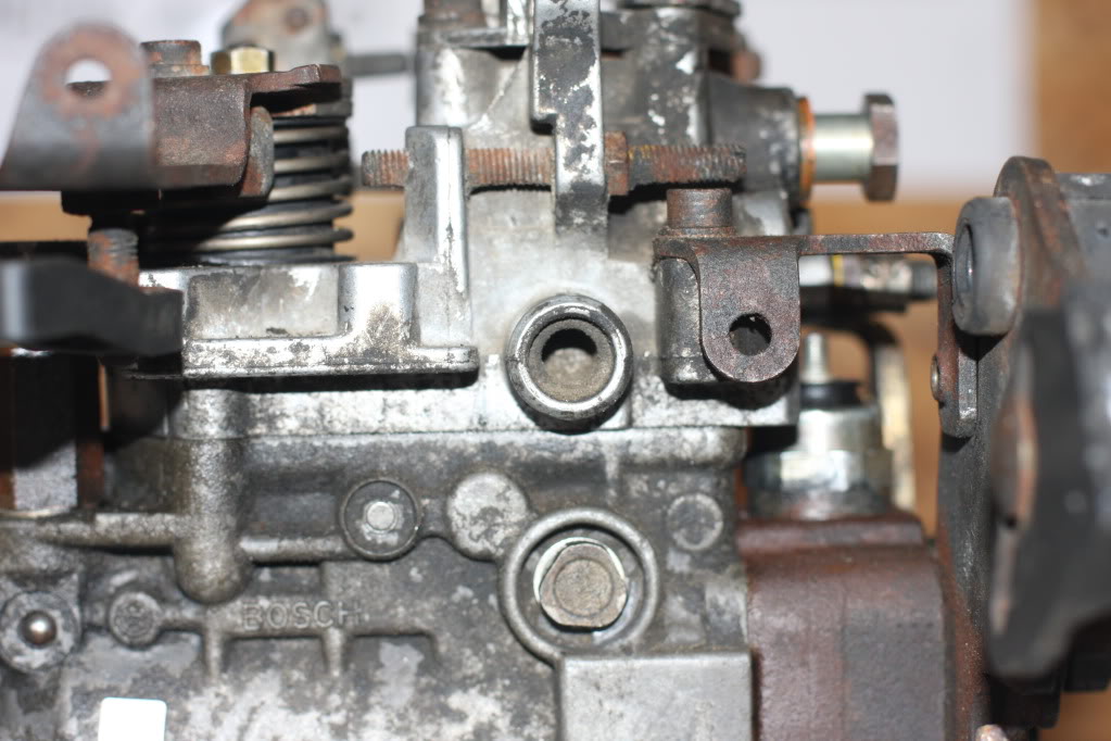

Oh And heres that BLEED screw

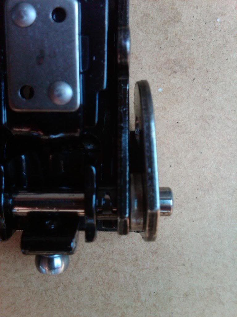

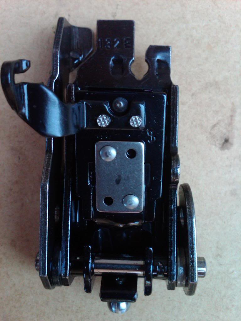

Managed to get the photo of my damaged parts up now.
clearly shows the kink,
a full image
and did'nt notice before but i thought i had cracked it trying to straighten it,
but this was taken before straightening and clearly shows already cracked.

Is that a crack in the lever assembly in the bottom photo?
Basically as long as it's just bent and not cracked then a careful straitening and checking that when it's mounted back on it's pivot screws that it's very free to move then it'll be very fine indeed. Only replace if that is indeed a crack.
If you do feel the need to replace it then the assembly is identical in any Bosch pump.
It looks a bit gummy in there so a good clean will not go amiss.

yes citrojim that is a crack.
Like i said I heard it groan when trying to straighten it but it was already cracked,

That's amazing the plunger plate broke like that
It must already have been weak. Are the big plunger springs OK?

Thanks to citrojim his generosity and his parts emporium the pump is in one piece again.A much appreciated cuppa and a good chin wag many thanks Jim.
And my god you were right about the pump Jim it did'nt look petty inside.
I only used one section of the govenor plates the other two parts were been eaten by whatever was in there !!.

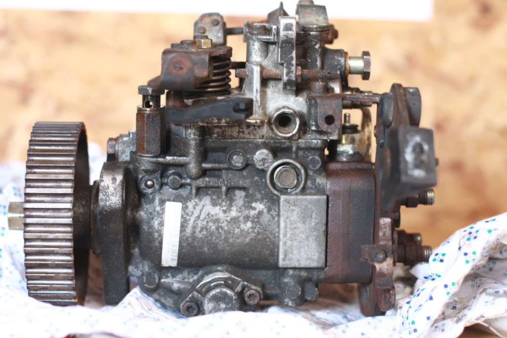

And this is the pump back together,I did clean it down but that black crud just dont come off,the bar code sticker came up clean ??!!.
And for those eagle eyed amongst you there is no STOP LEVER most odd.
