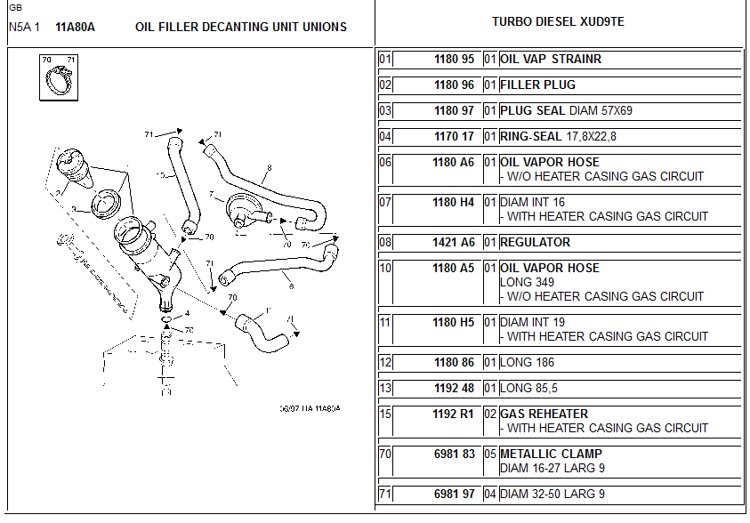

Cool.
What is that round thing by the way? I didn't follow the pipes from that at the time.
spider
Posts: 3949
Joined: 05 Jan 2010, 14:28
x 77
Unread post by spider »
Mine was in a different place (as its a 205) its connected between the inlet piping and the breather from the cylinder head or oil filler (depending on model) if I remember correctly (I no longer have the car to check) :)
Andy.
spider
Posts: 3949
x 77
Here is a pic to assist:
Note: This is a 306 with the 1.9TD (XUD9T) unit as I do not have any Citroën data, I doubt it differs much if at all from what you have:
Andy.
