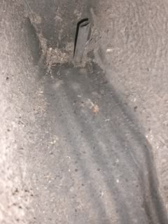

Front drain tube behind drivers side wheel arch liner-door end
Location of rear nearside drain tube in wheel arch
Mine exits horizontally (er.... no it doesn't it is more vertical on a second look) in the wheel arch-no need to remove liner (maybe my liner was missing though) and was clear
So if the rear offside is in a similar position it should be in the wheel arch behind the cross
However behind here is all the petrol filler pipe and associated pipework and as yet I havent found the outlet pipe for the sunroof drain tube

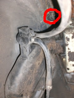

At the offside rear corner, I could not see a drain tube, could not feel a drain tube but water from the sunroof gully flowed down in a good torrent from somewhere up the top of the wheel arch.
Looked like it was round about the red circled area where there is a rubber grommet and an electrical connection poking through.
I guess it must have been coming from some orifice above this out of sight and out of reach.

I had the same troubles, couldn't find right side but left plainly visible so I dont think you're missing a piece
