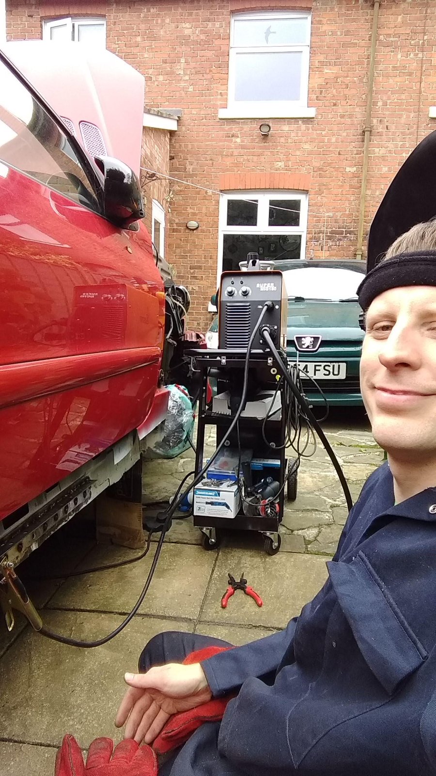

No expert in welding at all, but bought an inverter MIG setup off eBay when a quick investigation into a "small bubble in the underseal" on the 206 very quickly snowballed!
My welding tips for what it's worth adding in:
- get an auto-diming mask, available for about £35+ the permanently dark versions are a massive faff!
- MIG welder rather than stick welder. Stick good for thick steel but most car jobs are way to thin and burning holes and general frustration were result of trying to stick weld an exhaust, never mind thin bodywork!
- stuff gets hot enough to melt plastics (e.g. insulation on cables) in very short time. Hot enough to set stuff alight not a great deal longer! Carpets, wiring, etc inside floorpan at risk when "outside" fixing the sills
- on MIG setup, thin wire better for thin steel, I bought roll of 0.6mm, tips and the drive wheel inside the welder that pushes it down to the tip
- "hobby" gas bottles (little disposable type) give tiny run time and work out expensive in the long term. I bought /leased? a big bottle from "HobbyWeld"
- powerfile is great tool, essential, to grind back any mess and make a silk purse from a sow's ear!
