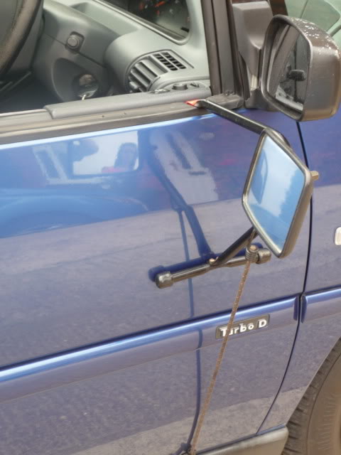

dieselnutjob wrote:I have found our 806 HDI to be a superb tow vehicle. The only let down is that with extension mirrors on the mirrors blow back. I have to tie them with string to keep them folding.
just make sure that nothing heavy is in the back of the caravan, with heaviest stuff over the axle, and you'll be fine.
Agreed, The Syn'/806 Mirror casings are ineadequate - not strong enough to hold extension mirrors - I broke one :roll:
:idea: I made this up from a couple of ancient tow - mirrors , the ones that used to fit on vehicle front wings .
A bit of tweaking to the top mounting ( which originally fitted between front wing / bonnet gap on older cars ) and protective tape - bingo.
Despite appearances the mirror sits - out more than enough , and is easily viewable at a glance . 8-) rock solid too. No additional mirror req'd for N/S due to driver's angle of view .
Hope this helps.
