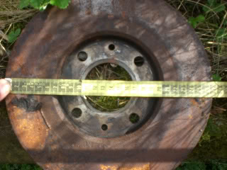

This is the disk that came off the front. I know the tailors tape measure is not very precise but the disk diameter looks like 265/266mm. The car had/has 14inch wheels. If I dont need the calipers for this current MOT exercise I am happy to find a new home for them, rather than leave them festering in my shed.

Ah good idea... I got my sizes mixed up earlyer... They are the smaller sizes...
Nice idea to measure them.. Lol..

I've just looked on Cit Serv and 266mm is the early hatch type which is what I'm after! Those discs don't look badly worn either, so again, if not needed by yourself, I'd be happy to provide a new home for them!

Thinking about it I may pass on the discs afterall, the years of standing may of done them no favours.

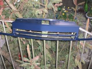

Any news from my previous post about the Chevron-less grille?

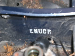

Heres a picture of the chevron-less grille. The flash has bleached the colour slightly its really a nice dark blue but I have photographed the code
which no doubt translates into something more exotically named.
Image Image
If you want it you can have it for the P&P price. Send me a PM if you want to do this.

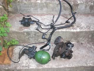

just a few bits heading for my shed including the "sinker" pump. If anyone can put it to productive use I will happily send it on.

DO NOT forget to recover the K joints for the strut feeds... ones under the LHM tank, the other at the rear subframe...

PM sent RE: Sinker Grille.

I just thought I'd give the breaker a free bump and say that the P&P on this item was superb and the turnaround was nice and trouble free.
All good here. :wink:
