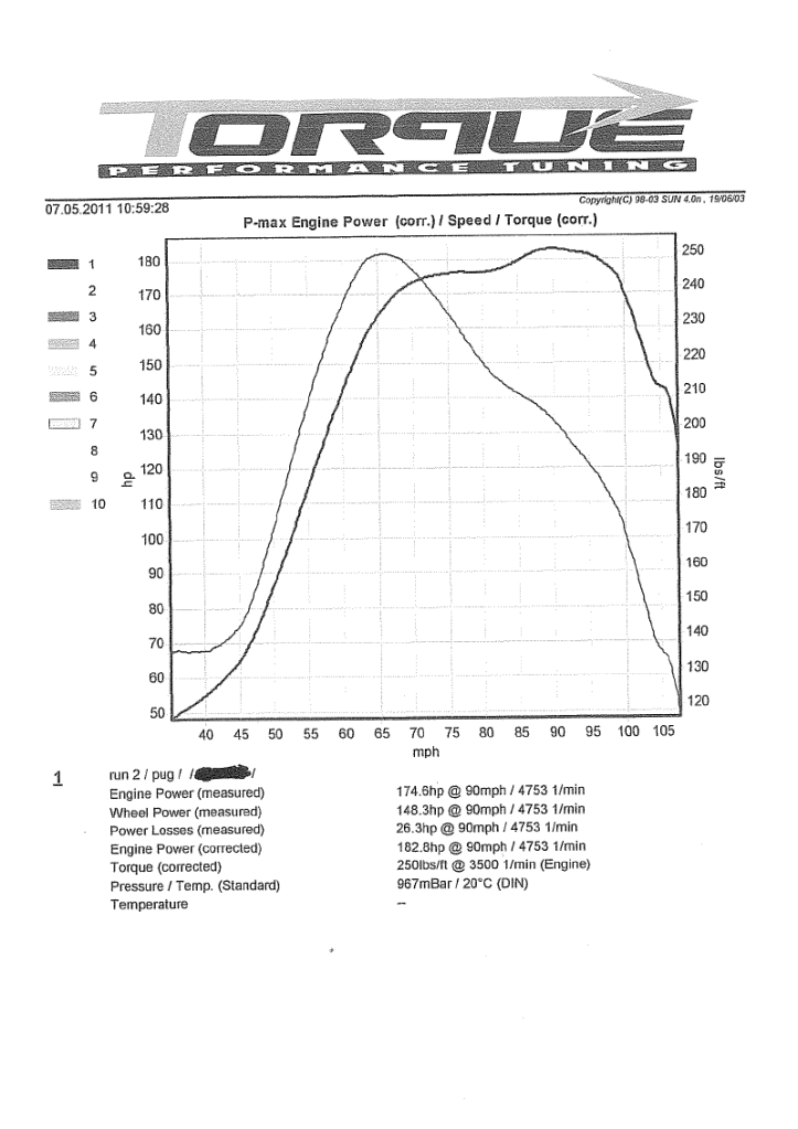

Another tuned XUD9T. I say tuned but this is the second of it's first dyno runs (first run had a sticking fuel pin) so guess there'll be more tweaking and improvements. (For some reason the RPM scale is incorrectly showing MPH?).
