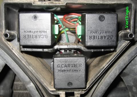

2.) Or the relays? The triangular relay box is seen in above pic.
and here's a closer look at it. You can find it from car breakers.
