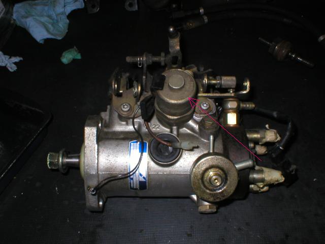

That's badpottsy189 wrote: I see mentioned about a needle , that is what the Citroën garage replaced when UG, but did not rectify the fault, they did not have a clue ! and I told them what to replace !!!!!!!!!!!!!!!!
The timing solenoid is easily enough tested with an ohmmeter. I have a similar pump here, although not an electronic one, and the solenoid has a resistance of 8 ohms. Disconnect it before testing.
Here's a picture showing teh timing solenoid on a similar pump:
An oscilloscope across it with the engine running will show if the ECU is supplying a signal to it...

On the older pump it is indeed Andy. I believe, and you have me seriously wondering now, that I thought I'd seen similar on a late electronic pump but your picture above does not show it so maybe the solenoid is in a different place and my memory/brain is letting me down. LHM poisoning setting in maybe
Mind you, the one I last saw was on a Ford Mundaneo...
Is the solenoid the device low down with the cable-tie around it in your picture? In roughly the same place as the boost overfuelling device in my picture?
