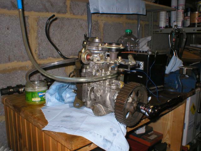

It depends on the pump type Warren. If it is a Lucas then it should spin over very freely indeed just with and pressure on the drive sprocket. Don't worry if you hear some little 'tinkles' as it spins as this is just the governor weights flying around. As I say, these pumps have have a shear section in the drive to prevent engine damage in case of pump seizure. If this has sheared than the pump will spin over with absolutely no resistance whatsoever. If good, you will feel some slight changes of resistance as it is spun over.warren555 wrote: Jim, how would I go about checking the staus of the fuel pump? I think you are very close to the mark as the original diagnosis was that the pump was faulty.
If a Bosch then it's a very different kettle of fish. It will feel very stiff and you'll be hard pressed to spin it by hand and normally a spanner on the end of the sprocket nut will be needed. Don't just screw on the nut without the sprocket and woodruff key in place or you'll never get the nut off again!
Apply a spanner and then you should feel four very distinct 'compressions' just as you would;d turning over an engine with a spanner on the crank pulley. Between compressions it should turn fairly easily.
This is not a test of operation, just a test it is not seized. It is possible to bench test it in a basic way by rigging up a little header tank on the fuel supply line and energising the stoop solenoid. If good, after a lot of rotations to fill the pump, four nice jets of fluid should squirt out of the delivery valves in turn.
If you do this, DON'T use diesel. Either use vegetable oil or very thin oil. Diesel is VERY dangerous when used like this. I use Citroen hydraulic fluid (LHM).
The picture below shows a bosch pump under test in the manner described....
I used a funnel as a header tank and a plastic line on the return line to save a lot of mess. You will need to spin the pump until test oil flows from the return line and then shortly after, jets should spurt out of the delivery ports and can spray about six feet.
