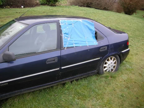

Some more, of the Sad Shots I have before I got her...
A not so Sad sight below!! :P
