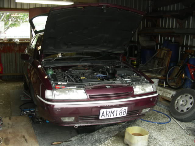

http://www.fastfrogs.co.nz/index.php/topic,5719.0.html
explains with photos how we changed the cam belt on a 1993 Xantia Si 2 liter 8Valve petrol with 120,000 Klms.
Cam belt. accessory belt and tensioner,plus water-pump.
some good goats turned up and decided to help put the cam belt and water pump in the Xantai, same job as BX similar XU motor,configuration.(VF7**************[VIN obfuscated, can be read by forum staff].RF)

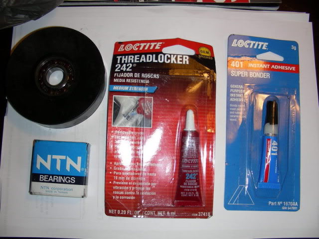

Cam Belt 94187,BNT Timaru(Citroen Fiat Peugeot)..$63.50 incl
Accessory Belt ribbed V Belt 6PK1650 BNT Timaru...$65.40
Loctite 242 threadlock 37418 BNT........................$13.70
Loctite 401.16704A Bearing adhesive.Repco...........$07.00
Water Pump Ex Cam,FFs www.multispares.co.nz.....$57.50
Supply No 00MS008 Part No Ordered QCP2944
Auto tensioner, Bearing only,NTN GSB 513 BNT.......$18.00

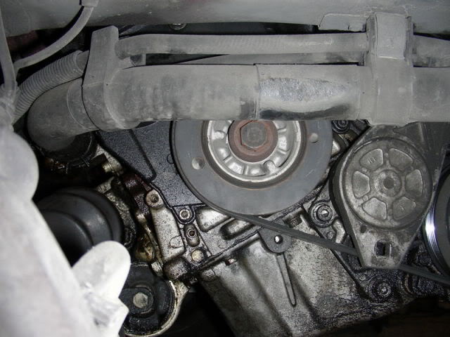

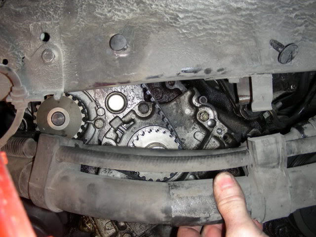

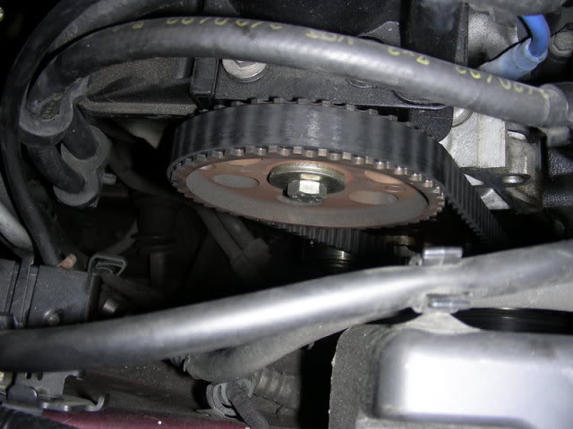

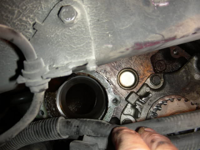

took top cam cover off to expose the cam belt and sprocket ,two quite long bolts.
the top curly clips hold the fuel hoses in place you will find the hoses in your way ,pays to tie them back up over the cam cover to prevent pulling them off.
hope you have got small hands,not a lot of space down there

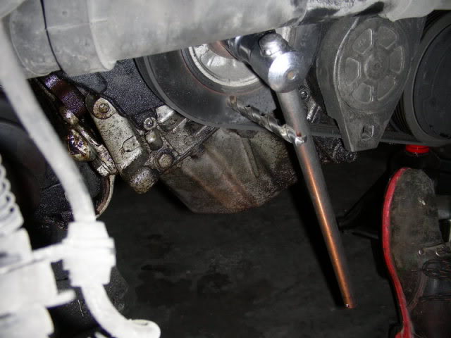

bottom camshaft pulley,nut is hidden behind radiator hoses,they will frustrate the hell out of you,but hey thats why you bought a French car !They can be unclipped and pulled down a bit.

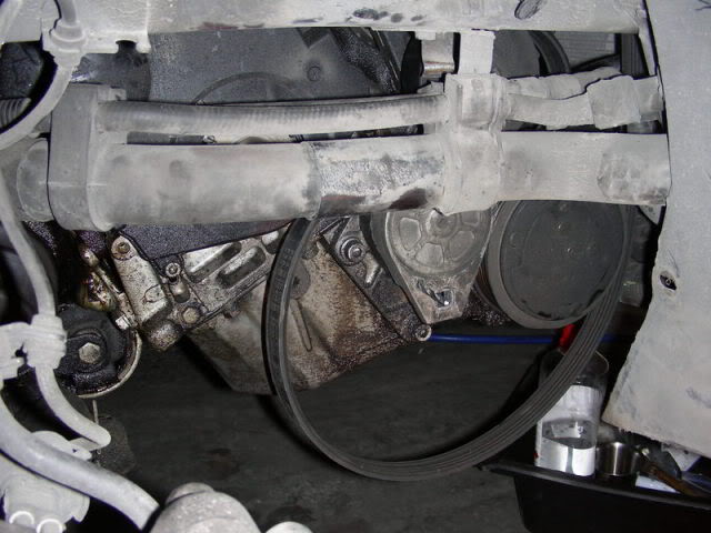

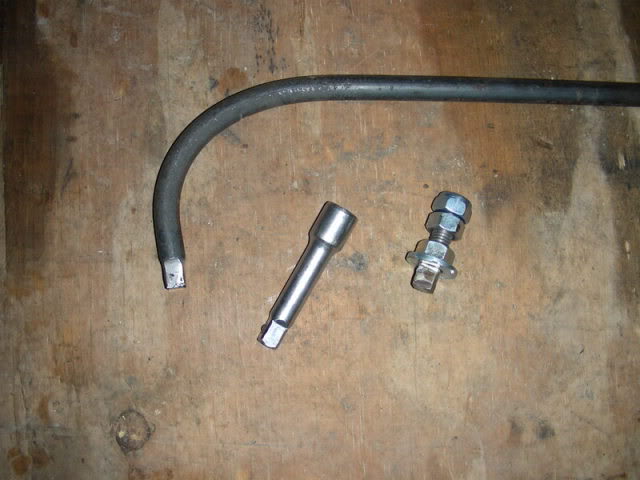

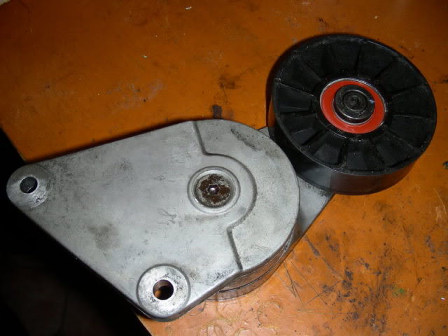

To the right in an easy to access place, is the accessory belt tensioner, the square hole is used to back off the tension(anti-clockwise) and the little hole beside it fits a 4mm drill bit to hold in place.Tis a rat trap, be careful.
used the rebar rod with a 10mm square grind on the end to fit the tensioner ,and bend to suit in the vice,this worked on my car as there was space to swing the bar,yours may have less space.
the nuts and bolts, was a futile attempt to bodge a gadget, ex the net,to do the above, did not work for me.the middle small extension would have worked,if ground down a little, but we did not have an adapter,in socket set to fit T bar breaker or Ratchet to my 1/2" drivers.

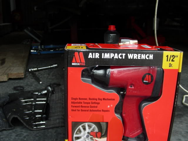

Bought the Rattle Gun on special from Repco,an unbelievable $66.38 on special.then the mongrels, buggered the feel good bargain,by trying to gouge my eyes out ,for $43 for a 23mm socket to fit same.
Actually went to Hirepool to rent a rattle gun,$50? but they did'nt have a 23mm socket,so wombled across the road to Murray Kitcher's Garage for some free advice,the boy told me they just put a sprocket on a breaker bar, brace it on a block of wood, and flick the key on the starter motor and Bobs your Acc client!
So we did, the Rattle gun at 220 ft Ibs wasn't shifting it !
Under this lot is the starter motor, on an Auto tranny car,take it out or loosen it a lot,to get at and jam the teeth on the ring gear to stop the crank from rotating.
On a manual car you just put it in gear and get someone to put foot on brake
On my car after a detailed examination of the area,we decided that we coulnt be FKd and just dealt to the crank bolt with a rattle gun as per Shanescitshed.com

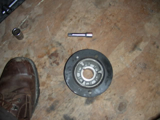

You will need a rattle gun (air or electric) to spin the camshaft pully bolt on/off on/off heaps of times.Its a tight fit and is hard to turn by hand.

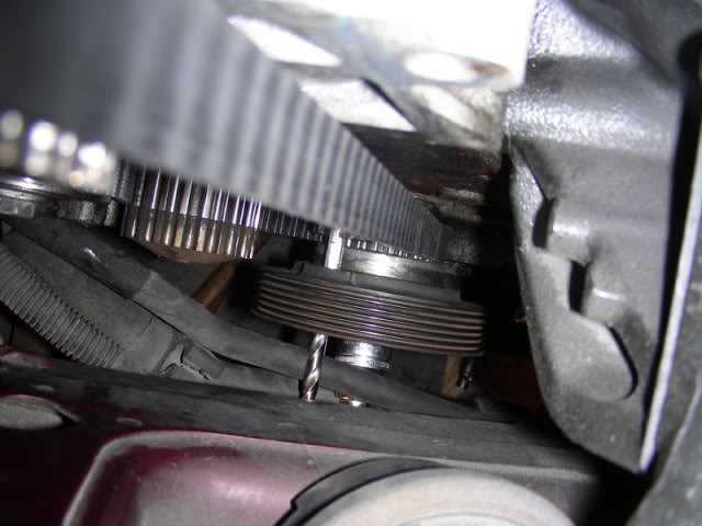

9.5mm drill bit in place locking the crankshaft pulley in place.
Do not leave the locking drill bit in position when undoing the crank bolt.The pulley has a cush drive,anti vibration drive and will be wrecked/damaged if locking pin is left in while undoing crank bolt.
the drill bit is for time ing purposes only, do not leave in when undoing the crank bolt.

accessory belt was reluctant to come off until, the tensioner was removed.

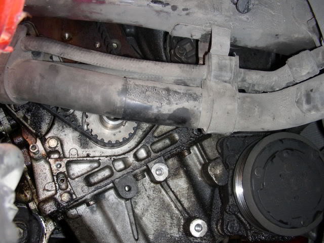

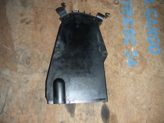

Pulley has to come off and the cam cover behind it to get at the timeing belt
the air con is bottom right,crank center,water-pump left
you can see how annoying the water hose pipes are?
you can see the 9.5mm drill bit locking the crank in place

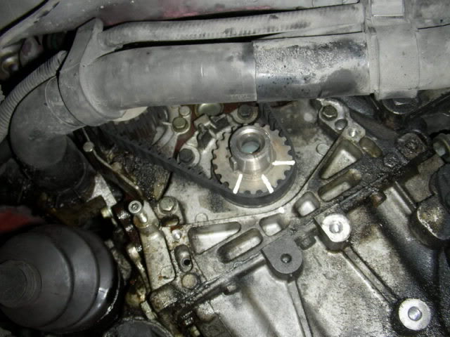

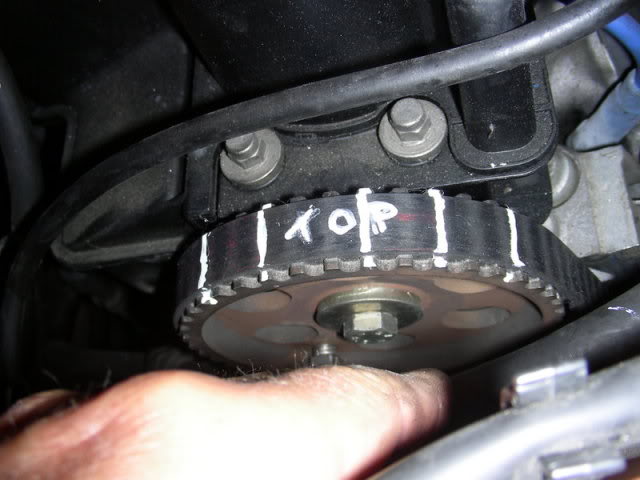

twink markings to double check new belt goes,where old belt is now?
doesn't matter? I didn't know it wasn't necessary, I'm just following what Ive seen on net!

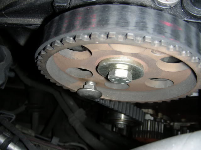

9mm bolt in cam sprocket,to lock in place,in retrospect using a bolt with a thread was a mistake,should have been a smooth shaft,as the bolt with its thread was a bitch to remove.

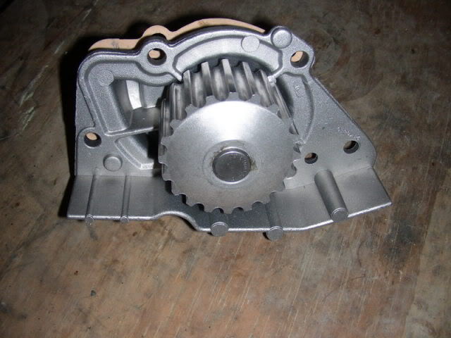

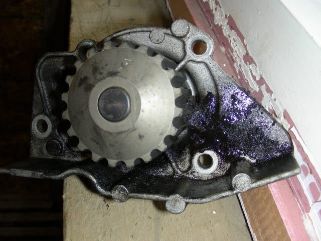

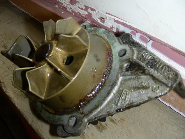

took water pump off,black scungy stuff on the out side of it looked like scrappings off the side of the timeing belt.
rust and corrosion debris on the inside. 120,000klm or 76,000miles on the old belt and waterpump.

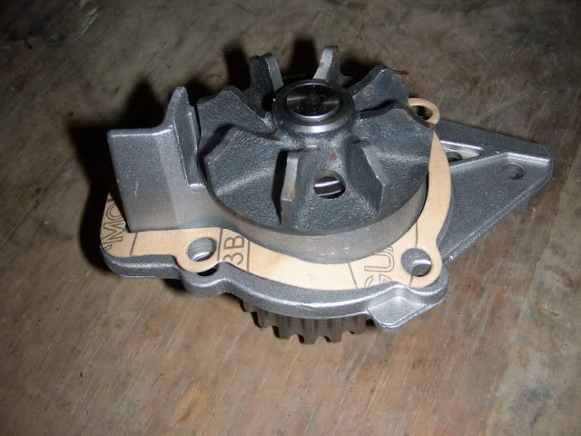

New pump ready to install,be aware there is a similar pump, with out the guard flange,for different series,spec cars.
now on to the Tensioner

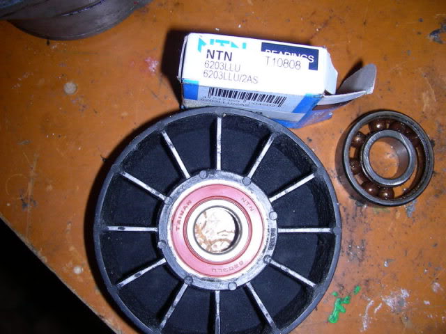

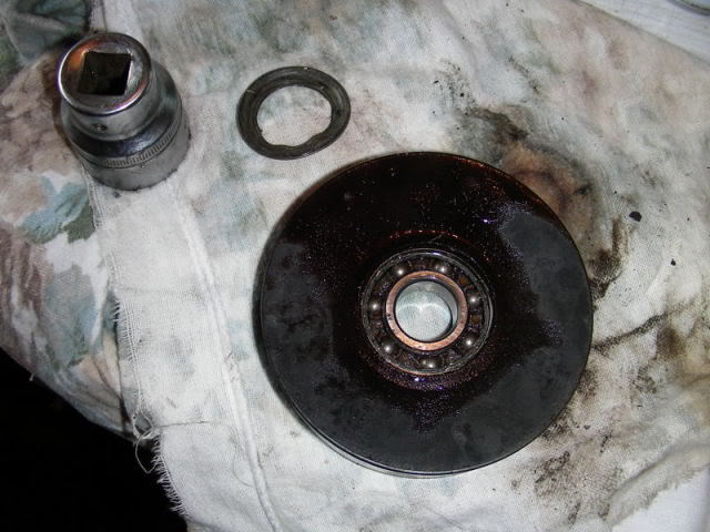

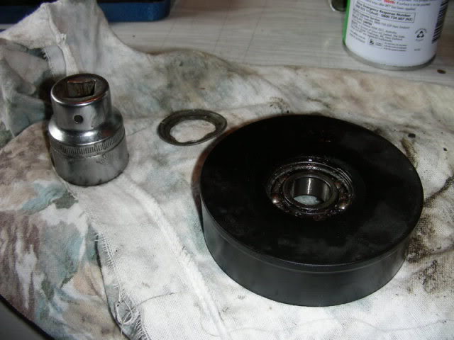

The bearing is stuffed.Repco quoted $550 for the auto tensioner complete,lucky?for us no supplier had one .
Same at BNT, and Super Cheap no surprises there.
Gave it a serious whacking with the socket,to dislodge remove it.
no hope of moving it,after taking it to the Guru's at Andar front shop down on the wharf.consensus of opinion was,it has a standard bearing in it,but good luck getting it out,of the injected plastic!(moulding of the tensioner wheel).

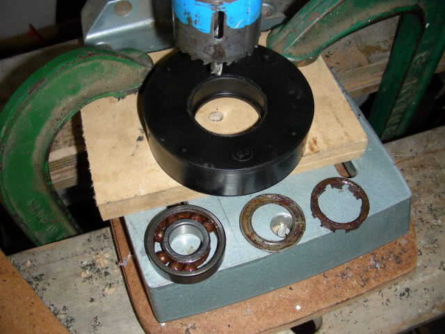

After knocking off for,lunch took the bearing to my shed and studied how it was made and assembled.
As the Book of Lies says,assembly is the reverse of dismantling.
Looking carefully at the bearing,and measuring the out side edge,we could see how much was embedded in the plastic.
So using the drill press,and a decent P@H hole saw,gently removed about 2mm of plastic encasing one side only of the plastic,tensioner wheel.
using this stuff (locktite),glued the new bearing into place.
"That will never work" try to explain thermal shock,differential expansion rates,
to a Speights drinker! How ever the twink episode was still in the air,so easier to show than discuss.
Put the bearing in the freezer,put the plastic bearing, in missus best dish, and hot water.
After a cup of coffee using same water! who says men cann't muti task.
Ready with the Locktite Bearing adhesive,glue the bearing into place.
A possible saving of approx $500 on quoted,total auto tensioner replacement.
not that we are in a position to be reamed by price gouging.
Auto tensioner with new bearing inserted.how to guide above.

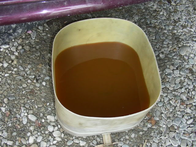

Bit of a worry when you find this s**t in your engine block/radiator

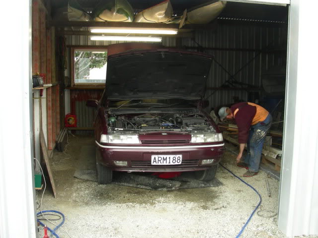

Mates Covered work shop,with a tarp under to catch all those things that go boinging off. minimum is a concrete pad under a shady tree.
this is absolutely luxury compared to my gravel carport!

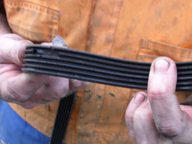

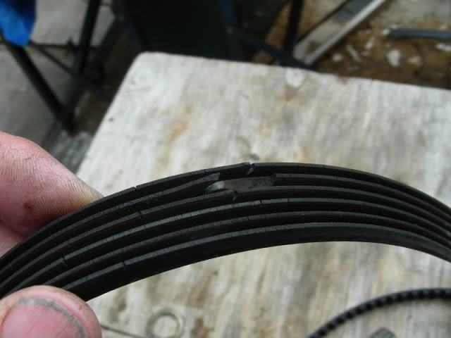

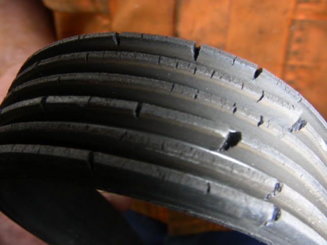

Old Accessory belt at 76,000miles or 120,000klm
don't know how much longer it would have lasted,but if it broke, no suspension,no brakes,no power steering
so if your Klms/miles are getting up there,put a accessory belt in the boot.

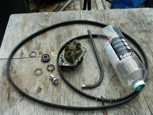

not that I'm paranoid!
Plastic bottle with bottom cut off,and insulation/plumbers tape around screw bit,is for jamming in the radiator fill/overflow tank,to raise the water level above the hieght of the heater taps and the bleed valves.

Examining the out side of the water pump,reveled a suspicious black scunge apparently from the cam belt that may have been caused by the worn auto tensioner pulley wheel.
the amount of wear on the side and the back of the belt, meant that in my view it was seriously worn (60%)and hey its my car!
We could not see any much/damage to the teeth of cam belt,but after showing it around,opinions varied from(looks okay)to struth thats knackered.

The last photo worries me greatly...
I hope the drill bit is being used neither to undo the crank pulley bolt nor tighten it.
The timing hole is on the outside of the dual mass pulley and doing either of the above jobs is a good way to wreck the pulley. The bond between inner and outer is likely to break down.
The best way to undo the pulley bolt is to pop the car into fifth gear and apply the brakes. On a petrol engine this bolt is only torqued to 80 ft lb or so.
Also, never rely on this hole for timing. Invariably, because it's on the outside annulus, it does slip over time with respect to the inner and the timing hole ends up in a different place.
I use an old solid pulley from a scrap 205 for timing purposes.

yes Jim you are quite right,the cush drive crank pulley is very easily damaged,some have been known to have rotated in use and thus the timing will be at risk if used as the locking guide.
i did not know about the solid crankshaft pulley,but it appears we got away with the way we did the job,as the car runs fine.!
I think it was your guide we used to give us the confidence to do the job!
Good point about the crankshaft pulley.
As an aside we could not get our crank pulley bolt off,even with 220 ft Ibs on the rattle gun,and had to resort to Butcher/dodge as described in the Fast frog thread.

If you look closely at the sprockets, the cam one has a little dot on one of the pokey out bits and the crank one as a little dot on one of the pokey in bits so if you only twink those two you can't go wrong. Some belts are even pre-twinked to correspond with the dots.
