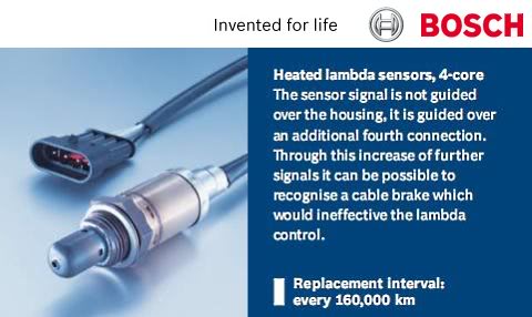

Unread post by VertVega »
It's nice to hear that the problem is solved Image
and also very nice that you've told us the solution 8-)
- Bosch Lambda sensor is max. 160k km for heated 4 wired models (data from Bosch).
My original lambda sensor lasted for an unbelievable ~ 250k km :shock: Good Quality!.
- MAP sensor life span was shorter, something around 180k km I had to change it.
Edit:
merlin617 wrote:... can they half fail ? can you test them off the car? ...
They can half fail.
They both can raise an error code in ECU. It can be read/erased, for example by Lexia.
We have same engine and this type of lambda sensor is in 2.0i 16V Xantias.
From Bosch web pages:

Unread post by addo »
The best way to evaluate a lambada sensor is to watch the voltage steps with a "known good" unit.
If the original behaves similarly, it's fine. Mine is good, and it's at 180K (kilometres).
