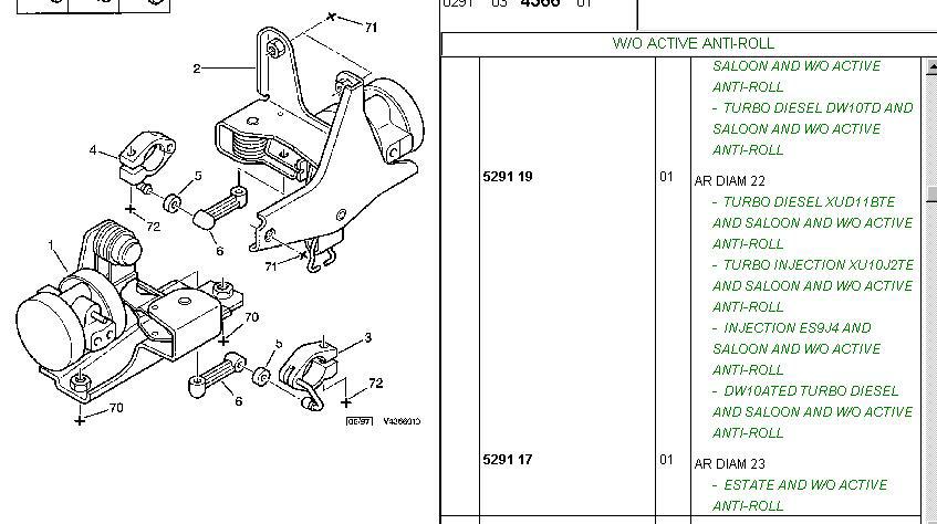

Here you go Stuart...
they vary, depending on model.
If its a 110HDi hatch you'll need the 22mm one 5291 19 or if you have the estate, 5291 17. The 23mm one.
Picture:
Item 4 is what you need.
Hope that helps...
