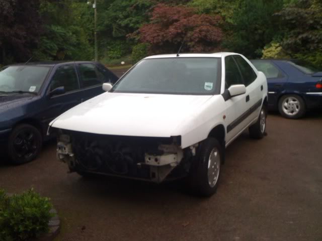

Todays progress was that we got the interior back together, just needs the front seats going back in and the steering column surround putting back on, it seriously looks (and smells) a million times better than it did.
We also whipped off the front bumper to find the slam panel was cracked in a few places, so we took that off too. Priced one up from a scrappy at about £10-15 quid which is good enough for me. Will see how much they want for the bumper and consider using that (dark green IIRC) until I find a white one. Somehow the rest of the front end is intact, and it must have just missed the airbag sensors as they're both OK.
So this is how it stands at the minute:
Can see my first car (306), second car (Activa) and my third car all in one picture, and it wasn't intentional :lol:
