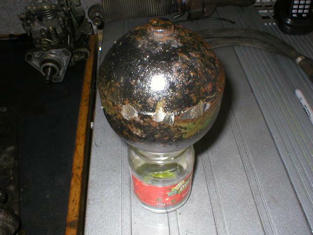

Perhaps punch was the wrong word. A drift might be better term to use. I use a drift with a roughly 3/8" flat tip and about a foot long. Fundamentally, any old piece of steel rod will do. I have an old Morris 8 half-shaft for serious drifting work.xantia sx auto wrote: any idea what i can use as a punch? do you mean the seam on the fattest part of the darn sphere? is it not filled with gas!!!??? sounds a little dodgy!
All spheres have normal right-hand threads. If you have any doubt as to which way they should undo, hold a nut and bolt next to the sphere and undo the nut from the bolt. That'll show the direction but basically, normal RH thread that unscrews anti-clockwise.
Honestly, you can really pound a sphere with a drift and you won't puncture it. they are made of thick steel.
Here's a picture of a particularly recalcitrant sphere I removed from my Activa project. It took three attempts and you can see on the seam where I raised three ridges and flattened them again in my removal attempts. That one honestly took serious welly to remove.
So no worries but do mind the rad. I put a piece of ply in front of it so if the worst does happen....
