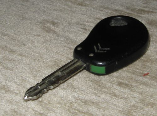

keys, do they really have to be this big???!!

It seems that some people don't realise that the transponder chip for the immobiliser is in the plastic mouled end of the key shaft itself, and has no connection to the RF PCB that works the locking system.
Your car would originally have had a service key which has a slim plastic head and no plipper body, at a cost, you could get a replacement from Citroen, or you could just pop the rivet and find a way to get a bit of leverage on the key shaft from your plipper.

oh cool thanks, any idea how to pop this rivet??? I doubt ciroen would help as i don't have the card thing with key numbers on, but could they make a service key from my key or would they need key codes and does anybody know what it might cost me? (probably more than i paid for the car!!!)xantia_v6 wrote:It seems that some people don't realise that the transponder chip for the immobiliser is in the plastic mouled end of the key shaft itself, and has no connection to the RF PCB that works the locking system.

I don't have the service key that is my problem!jgra1 wrote:http://1.bp.blogspot.com/_2fj8MH_LeQ0/S ... antkey.jpg
the service key.. the green bit is the chip.. looks quite well secured

I would get a service key, it wont cost a fortune and you will have a good sized key, instead of a tiny plastic ended blade.
If you do decide to drill out the rivet, Citroen sell a kit for a couple of pound which is the rivet and spring.

How can i get a service key if i don't have that card with key numbers on? i thought they needed the number to make it work in the car for immob???Citroenmad wrote:I would get a service key, it wont cost a fortune and you will have a good sized key, instead of a tiny plastic ended blade.

Citroen dealer can look up the key number on their database. They may or may not charge for doing this. If you have to obtain the key number, it's worth getting the radio code and the security code as well. You may also need the V5 document to "prove" that you own the car.

The "standard" charge used to be £15 for the 3 codes. I was quoted £15 for each number by one local dealer.
I went to the main dealer in Gloucester eventually (happened to be passing) and was given the 3 codes for nowt.
(I always think that being pleasant and polite is a help.
The radio code can be accessed by the dealer at any time but the other 2 can only be accessed when the main Citroen UK database is open (9 to 5 Mon to fri?) The dealer gave me the radio code but being Saturday couldn't do the other codes. I said that a phone call with the others would be ok, when he had them. It would save me calling in. I then offered to pay and was told to not worry about it.
You have proof of ownership with the slip, and presumably you'll drive to the dealer in it so ownership won't be a problem.
