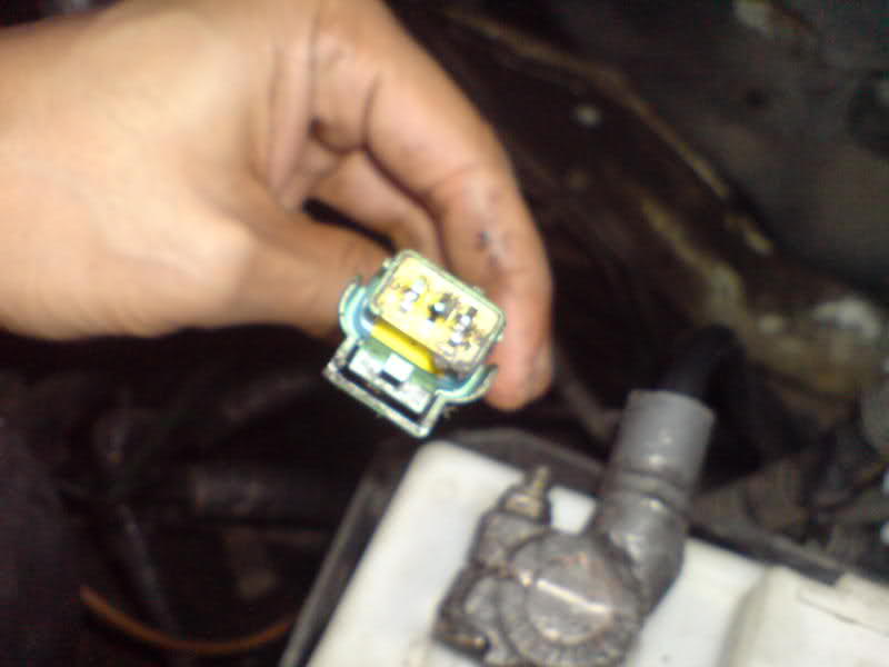

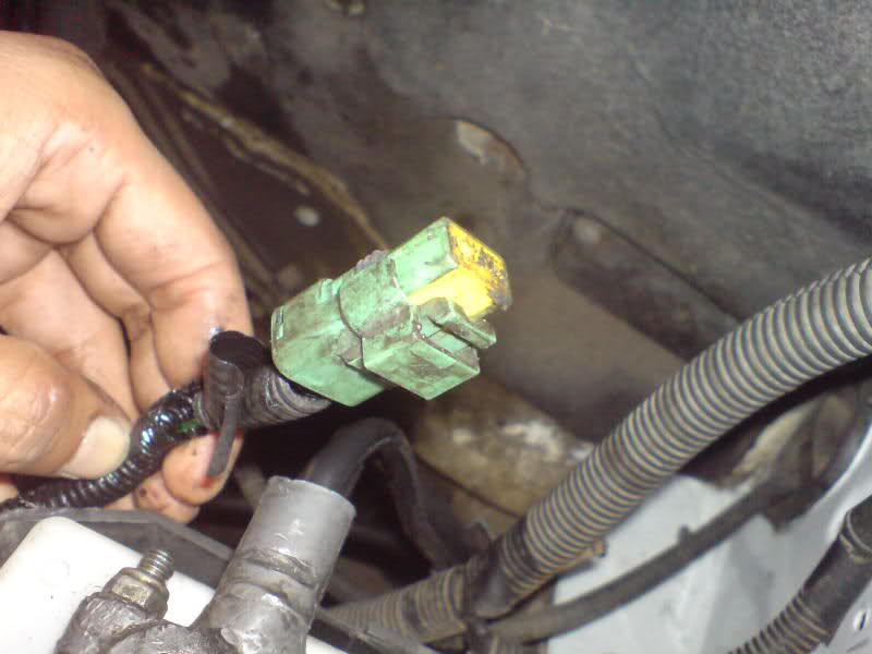

I have the 3pin connector already connected to the g/box, will post some pics of concerned 2pin plug.

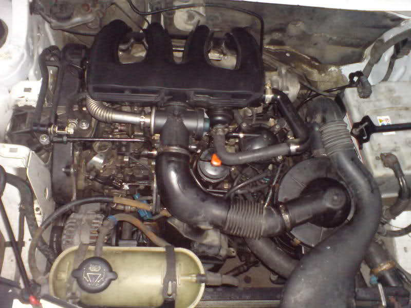

Find below a pic of the engine bay, can someone point out where I adjust the fueling as I cannot seem to find the place as instructed here.
Also what does this connect to, I am hoping this is the reason why my speedo is not working, also any ideas where this plugs into?

If that's a Bosch pump the fuel adjustment screw should be on the back of the pump directly under the air intake pipe, about where the circlip is.
For your starting problem, I would think that your glow plugs are not working, connect a meter from one terminal to earth, it should read about 10-11 volts when in cold start mode.
