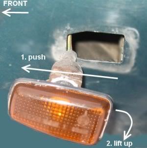

* Xantia's side light bulb replacement is simple. May be this is similar in berlingo.
The bulb can be replaced by removing the bulb holder a quarter turn.
Edit: Pic. added.

Its the older type with the painted on numbers, have worked out how to get the sidelight out now, all I need is the bulbs, and someone with a manual to let me know which number the fuse is for the dash lights.
Thanks

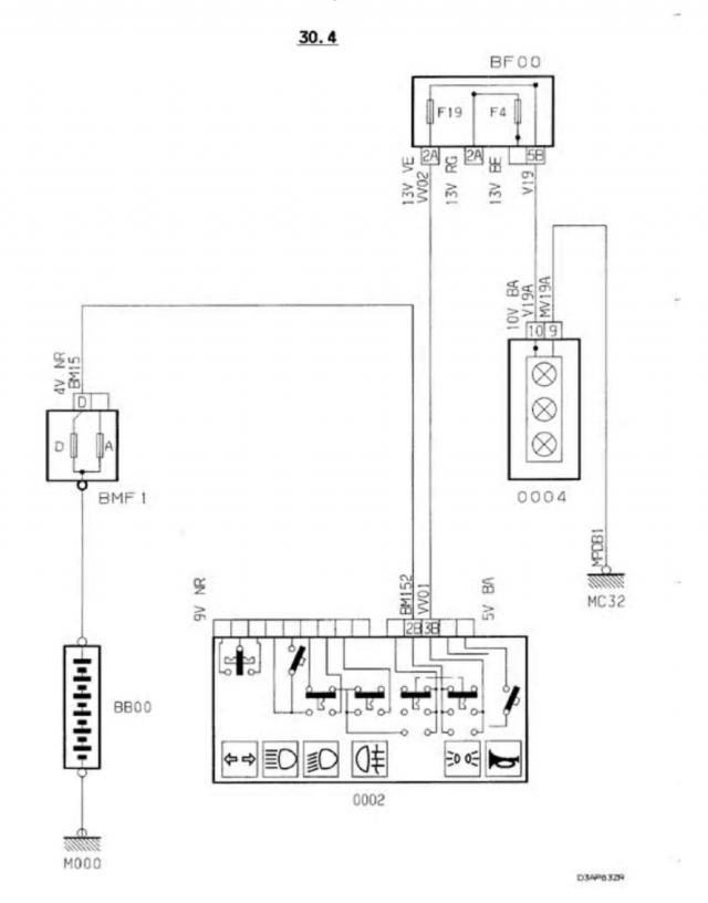

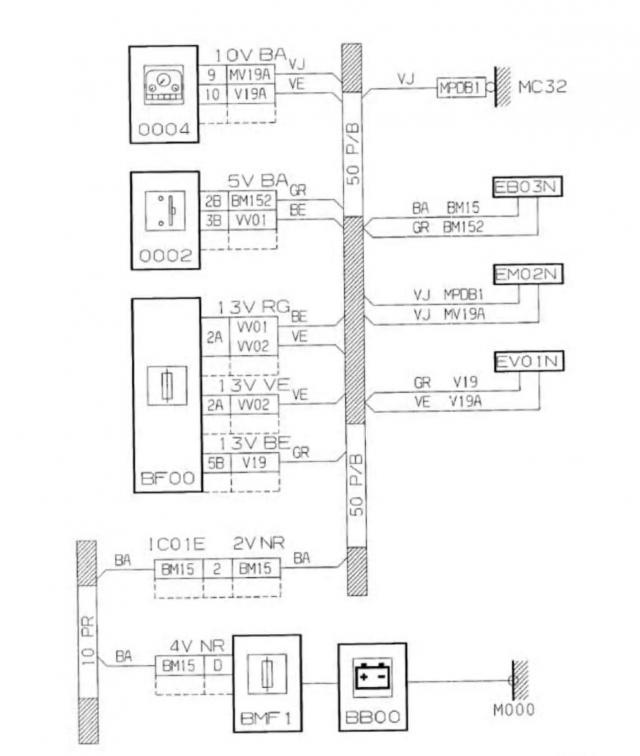

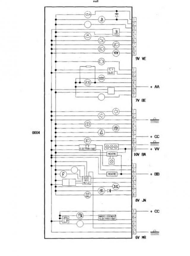

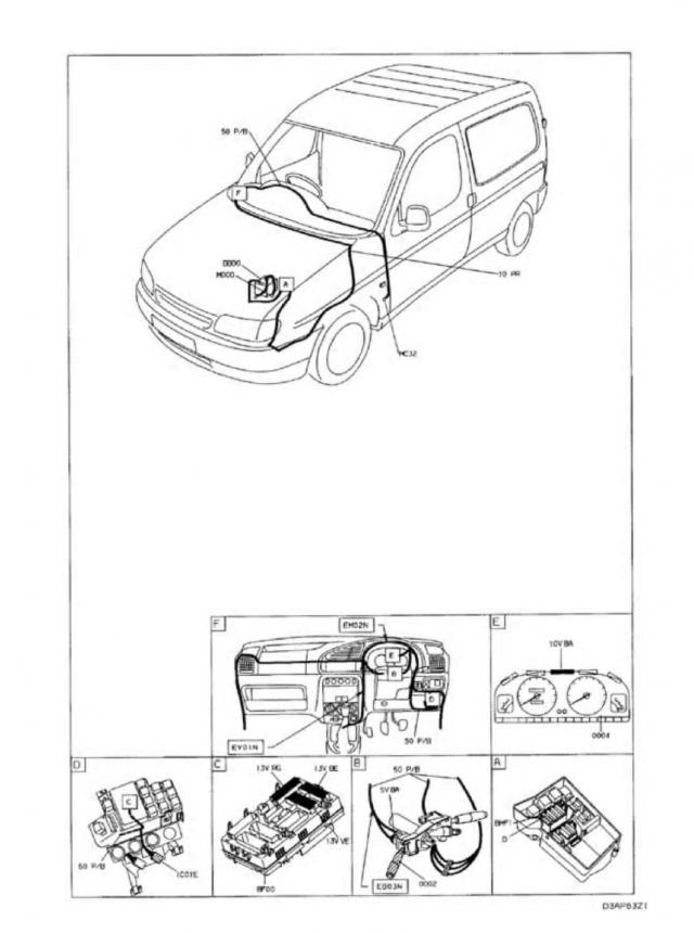

Paul. Here's all you need to check all electric chains of instrument panel in your car.
Instrument panel schematic diagram:
Pictures below shows how and where instrument panel connected in your car:
