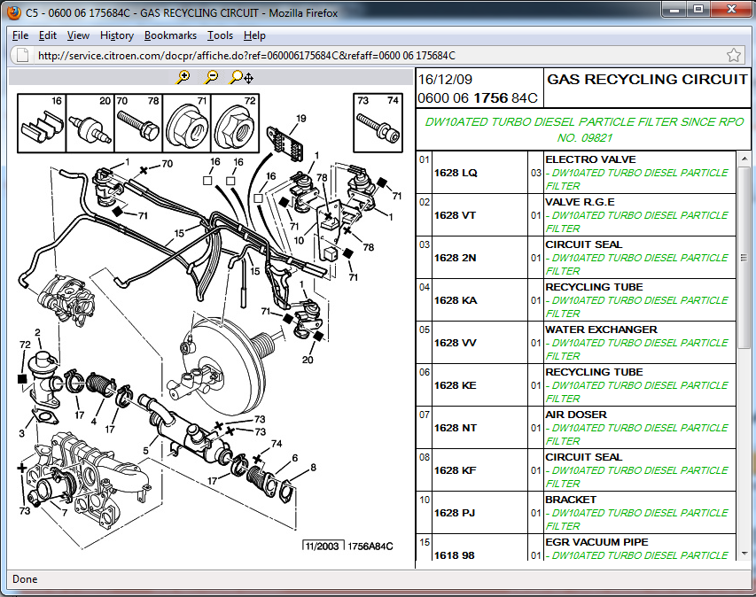

Looks like the EGR electrovalve on the servicebox..
Part number 1

YEah aircon works. It is this part though making the noise I put screw driver on it and it buzzes. The garage owner who did my head gasket felt it last night and he said he could feel it vibrating. Not sure what it is. I did ask the garage today to check it but no mention and I forgot to ask.

Turbo boost solenoid. Take them off and shake them if they rattle then there ok if they dont then there goosed. If there ok then check the vacum pipes and wiring to it

Those vacuum solenoid valves are controlled by a modulated DC, so, the sound could be the coil of the solenoid humming with whatever may be being applied to it in terms on a modulated square wave of 12V DC.
Just like the humming of an electrovalve on a hydractive Xantia.

What I'm trying to describe is a method of getting a voltage which is variable from a fixed 12 V battery/alternator.
See if this makes sense:-
If you put full battery volts onto a component then thats 12 Volts.
Now, if you have an electronic board which switches the volts on for say 1 second and then off for 1 sec then back on and off and on repeatedly then that means you get an average of 6 volts applied. i.e. 12v for 1 sec and zero for 1 sec gives average of 6 volts over the 2 seconds.
If you switch on for 1 sec and off for 3 secs and then on and off for the same period over and over , you get an average of 3 volts i.e. a quarter of the full volts.
The control solenoids on the C5 engine are controlled in this way to change them from fully open to partly open or fully closed, but, the switching is much faster than 1 sec at a time.
So, your buzzing solenoid is probably receiving a quickly switched 12 volts to achieve a much lower average voltage and this choppy supply is probably causing it to buzzzzzz.
Your solenoid may not be faulty at all, it could just be noisy. The electrovalves on the Xantia buzzz like this because once they're switched at 12 volts the electronic control then chops the 12 v to give an average of 3 volts to hold the electrovalves in the on position.

Just had a thought about these solenoids.. They must need a diode to release the energy stored in the coil when the DC is switched off.
The problem could be that the diode on your noisy solenoid has failed.
On the Xantia electrovalves a standard mod is to fit a new diode.
It's probably going to be easier to just change the solenoid.
It would be interesting to see if a diode mod would work.
