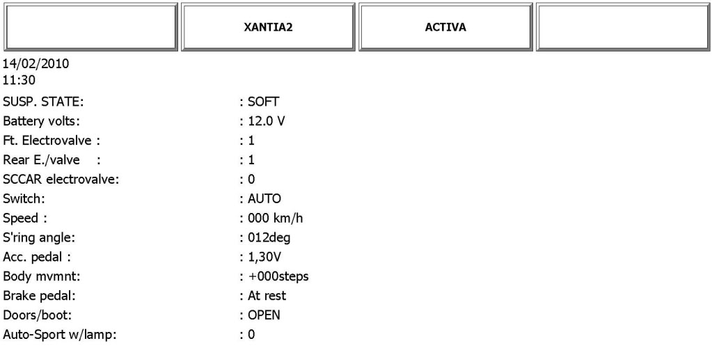

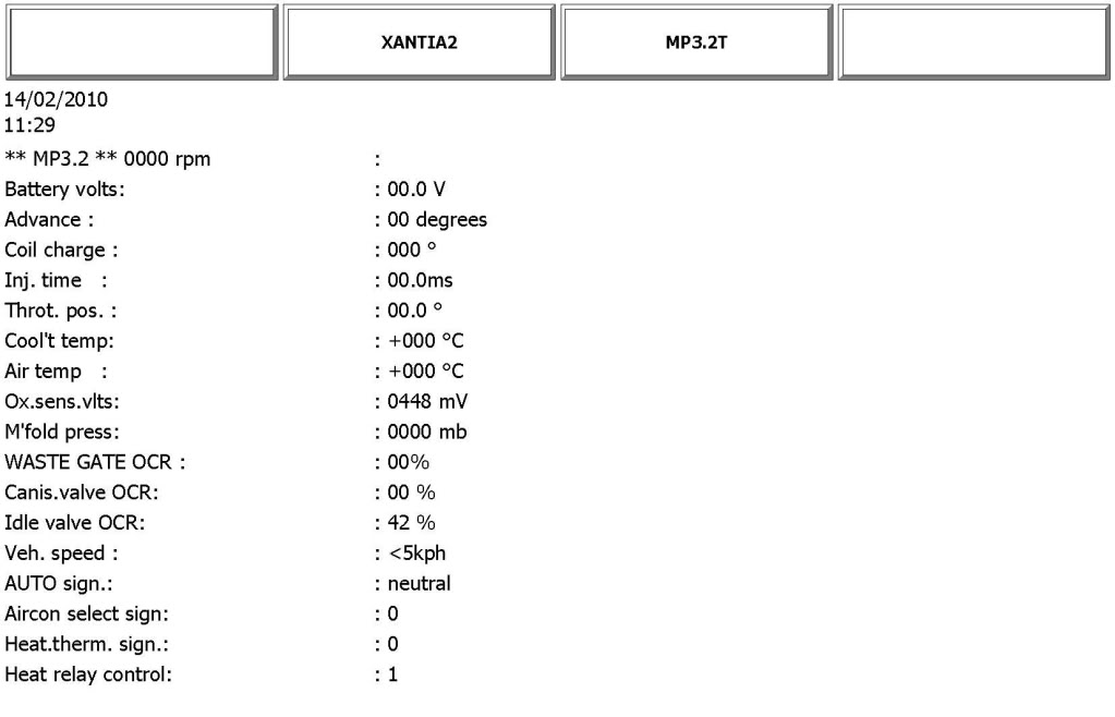

Hi to all
After many many hours of trying to fix my problems i started to think how trouble free was my previous Xantia 1.6....
Anyway i am waiting a left front strut to come from UK as mine started to internally leak badly and finally lost 0.5 liters of LHM in 3-4 minutes. I am also waiting from GSF 5liters of hudraflush as here in Greece this thing is unknown!!!!!
I have some questions to make.
1. Foam in the LHM and air in Brakes. I temporarily used a transparent pipe from tank to pump and i saw that tons of air were getting in the circuit
I hope that with hydraflush this will be solved. (Filters and tank are clean the LHM maybe very old)
If this wont fix the problem, i will change all spheres and then..... i think that I will sell the car as spares...
2. Vehicle Speed Sensor. The wiring is OK the speedometer is OK.
The Lexia shows the following.
for the suspension ECU. The speed parameter is always 000 and the car always in Soft mode.
And
For the engine ECU. Here the veh. speed is always <5kph.
Another thing that is odd to me is the AUTO Sign. : neutral.....
My car has a manual gear box, is this normal??????
I have ordered a spare VSS just to see if mine is half dead, but i am afraid that i will not be able to fix this fundamental problem.
regards
Lefteris

Are those taken with the engine running?! And did you really have a door open? Pretty sure it won't switch to firm with a door open.
I wouldn't worry about the autobox thing (nearly sure mine says the same) but there is a lot missing.

No the readings ware taken with engine switched off AND the door open as the car can"t move due to the strut problem. The only thing that prevents the car to switch to firm mode is the speed sensor.
If the auto box thing is normal, maybe with a new sensor the problem will be solved....
Thanks
Lefteris

Hi Lefteris,
With the ignition on, a door open and the engine not running, you will never see the system switch to hard mode. The only time you will see hard mode on the Lexia is when driving hard around a bend, braking hard or accelerating and then only very briefly.
Check like this. With ignition off, open a door. Listen for a click and a hum sound from the electroalves. Close the door and listen to the electrovalves. They will hum for a further 30 seconds and then switch off with a click as the ECU selects hard mode to prevent battery drain.
The speed sensor is fine if the speedo works properly. The same sensor drives both the speeo and the ECUs.

you misunderstood me. i have driven the car for many kilometers with the lexia connected and all work fine, except speed readings in both screens.With the ignition on, a door open and the engine not running, you will never see the system switch to hard mode. The only time you will see hard mode on the Lexia is when driving hard around a bend, braking hard or accelerating and then only very briefly.
it works as it should. But on the move never switches to hard mode.Check like this. With ignition off, open a door. Listen for a click and a hum sound from the electroalves. Close the door and listen to the electrovalves. They will hum for a further 30 seconds and then switch off with a click as the ECU selects hard mode to prevent battery drain.

Hi Lefteris,
Sorry for the late reply
It is odd that both ECUs do not indicate any road speed although you say the speedometer works?
Both ECUs and the speedometer are fed by exactly the same signal from the vehicle speed sensor so if the speedometer does work then it has to be a wiring fault. I can supply the necessary diagrams to help find the wiring fault if this will help.
You are right that the Hydractive/Activa ECU will never switch the Activa Electrovalve if there is no road speed signal. This is a vital signal for the system to work.

Not only the Activa Electrovalve, but all 3 of them. That is why the system stays in soft mode always. I have found this strange problem in the XM ForumCitroJim wrote:You are right that the Hydractive/Activa ECU will never switch the Activa Electrovalve if there is no road speed signal
http://www.club-xm.co.uk/forum/viewtopic.php?f=7&t=996
I have downloaded the diagrams from service.citroen.com. The strange thing here is that the wiring seems to be ok.CitroJim wrote:Both ECUs and the speedometer are fed by exactly the same signal from the vehicle speed sensor so if the speedometer does work then it has to be a wiring fault. I can supply the necessary diagrams to help find the wiring fault if this will help
Already I have checked that the singnal pin of the sensor and the pin 11 of the ACTIVA ECU (White connector) have conduity (Ommeter shows 0.00)
Furthermore the pin 11 of the ACTIVA ECU AND the pin 9 of the engine ECU also have conduity
So since my speedometer works and the signal goes to both ECU's i cant understand what to do.
Next thing to try is to feed the Pin11 with the signal from the speedometer with a thin long wire.
Maybe the sensor is not providing a strong signal, so the speedometer it might not be so sensitive as the ECU's and can read the speed.
Anyway i hope soon to receive my new speed sensor...... from UK again

I have just thought of something.... when the car is stationary (speed 000), engine running, the suspension is in soft mode. If i press the accelerator pedal suddenly all the way down and release it before the engine blows out, what the suspension should do
I am asking this, because according to my lexia, my suspension stays in soft mode. If it shouldn't then maybe i have a problem with ECU.
Thanks again
Lefteris
