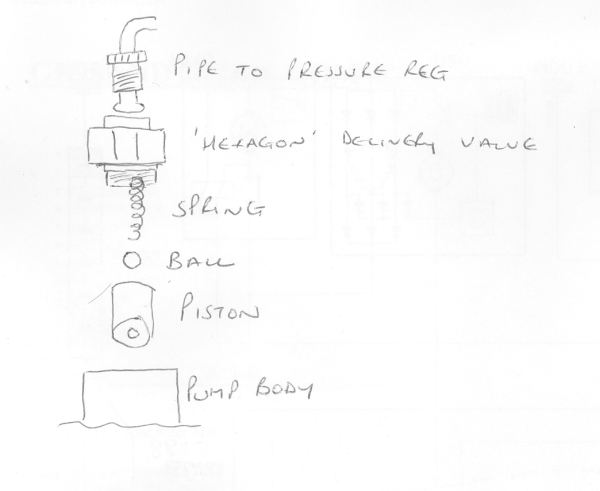

Yes, there is!lexi wrote:There is no ball valve in there ?
Under the hexogon, which contains a delivery valve staked in, is a big spring and at the bottom of the spring sits a ball bearing in the piston.
The piston (one of the two pumping elements) is like a U shaped bucket with a hole in the bottom and the ball bearing keeps that hole closed by pressure from the spring.
If the ball bearing is not there then you'll never build pressure.
Did you remove the spring? Chances are, if you did, the ball came out along with it, you did not spot it and the ball made a bid for freedom...
No worries, I have a spare ball you can have but not a spring...

Aha! Never saw ball at all
On removing spring there was so much fluid that I think it will have pushed ball out. I cleaned and dried all off and noticed the small hole and thought it strange that the spring would sit across the oriface. Not having a drawing I put it back together thinking spring may be to reduce flow (unusual) .
I did ask it back in thread ( first post)....ah well hopefully this could be cause........and no cause without reason

Yep, looks like you've lost your ball Lexi
If you look at the delivery valve that is in the hexagon you remove, there is no ball there, what just looks like a flat plate if you look into the bottom of the hole. The ball goes into the bottom of the U shaped piston and as you say, the LHM could well have pushed it out. It's only a little ball.
If you look down into the piston and see no ball, that's it! If so, PM me your address and I'll pop one in the post....
Would a little drawing help to confirm all this?

Funny thing is that I only removed the spring as there was no rubber seal on my larger union. I thought there may have been bits of it fell in the system. I haven`t removed any hexagon section Jim ....ah sorry mate you mean that 19 mm plug that holds the pipe union.........yes removed that to put my new seal on. As long as the ball goes under that spring all should be good.
