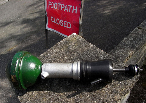

The gaiter is on the strut and encloses the moving parts to protect them from dirt and corrosion. It also collects the leading fluid and returns it to the reservoir.
Similar but not quite the same as this:
The gaiter is the black rubber part. On the drawing you linked to it is #5 on the parts list.
Online pictures are rather sparse, I'll try and get one of my car.

as Steve says its part 5 on you diagram, appart from that is a front strut not a rear, the photo Steve has added is a rear strut/ram (suspension unit ) with sphere still attatched,

Also it is a Xantia strut, not C5 but the principle is the same. The C5 rear is much longer and corrugated.
