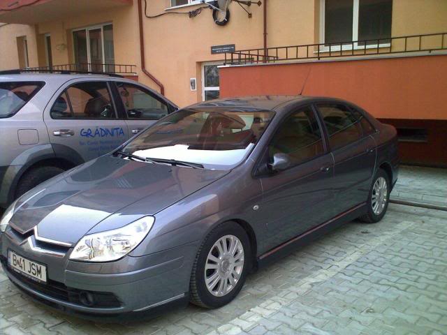

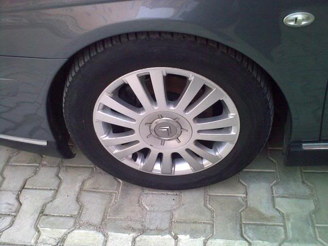

as you can notice in my pics there is a difference between front and rear and when I unlock it pump workin a little over 5 seconds and again when I sit in the car.

pics when i saw this car first time:
