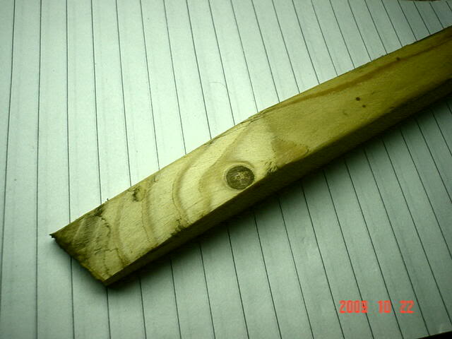

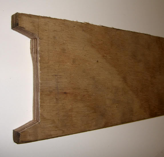

I am assuming the BX sender is similar, if so then this is the tool I made, note the angle on the end, this will allow the tool to tilt upward.
Engage the tool in a slot in the ring and tap with a hammer, then remove the tool and place in another slot 180 degrees from the previous, and tap again.
Repeat till the ring begins to rotate anti clockwise. It may help to inject a thin oil into the threads and leave a while to soak.
This thread may help to resolve the problem when the sender is removed.
Good luck
