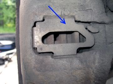

During some of those previous overhauls I had same case, caliper piston catching
Try hitting piston (flat head screw driver + hammer) to make it turn clockwise. After a couple of hits try lifting caliper. If not then couple of more hits... It is just a matter of some millimeters then it is free. (This is how I solve the problem.)
You can try either from gap below available by lifting caliper or from front face of caliper by removing the guard sheet metal.
Remember to assemble it back. Keep screw driver (or chisel) in a small angle, almost tangent to piston and try not to disturb any seals.
Don't hit piston too hard (not like a blacksmith but rather like a goldsmith
