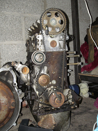

Dean on club-xm wrote:2.0 8v timing belt renewal, N/A and Turbo
This is one of the easiest timing belts to do of all XM's and with a little practice can be done no problems in under 2 hours, if its your first time leave a good half day though.
The turbocharged and normally aspirated versions have the same head and block, the unit pictured happens to be a stripped down N/A but both are the same.
Here is the unit in question, from the bottom up is the crank pulley, water pump, accentric tensioner and cam sprocket, the crank and cam are locked in place.

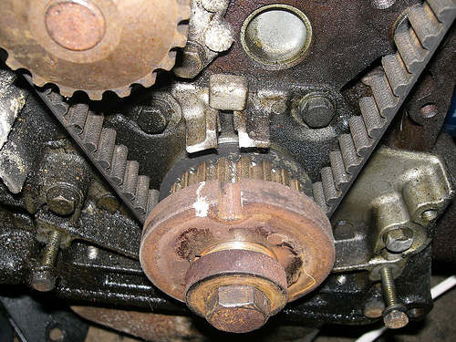

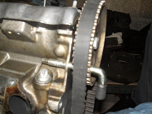

Here are some close up shots of the locking points at the timimg end of the engine, this is the cam viewed from behind the engine
This is the crank timing point without the 1/4" square bar in place, ignore the white marks, some Muppet has already been in there with the tippex, which is why it was a tooth out when i got it :|
