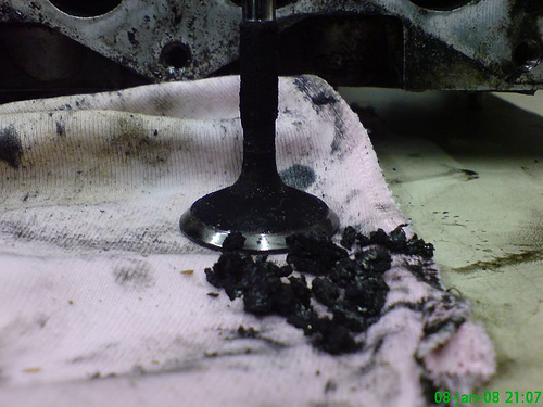

EGR valves do seem to attract loads of gunk don't they. I think it's down to the hot exhaust gases meeting the warm oily PCV gases.
Here's what I found on a 2.5 TD.
This was the amount of gunk from one inlet port of the same engine. It didn't use any oil or smoke more than you would expect. All the inlets were exactly the same.
Steve.

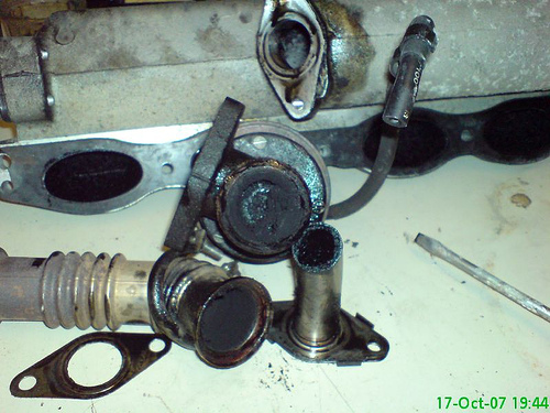

EGR's are the work of the devil and should be abolished IMO. (Ok, I don't believe in the devil but you get the meaning)
The following pics are from my 116K 1.9TD which, I guess has been sedately used by an old couple until my ownership.
Click to enlarge
It's all very well giving the engine an italian de-coke (thrash) but it does increase engine wear and accelerate oil degradation while ruining the economy but having to do so even more because of this evil device is just taking the proverbial and is a poor band-aid solution which does nothing to the clear the intake restrictions caused.
Incidentally, because of the restrictions an EGR system creates, you have to use more fuel to achieve the same power output/work thus increasing pollution, not decreasing it!

But of course.Incidentally, because of the restrictions an EGR system creates, you have to use more fuel to achieve the same power output/work thus increasing pollution, not decreasing it!
Like practically all legislation of today, it is ill thought out, and without any real logic. The monkeys in Parliament (and elswhere) are utterly incompetant in the vast majority - AND many have their noses in the trough to boot.

Hard to see how a dynamic who's boss test (aka Italian decoke) could clear the intake side of things.....It's all very well giving the engine an italian de-coke (thrash) but it does increase engine wear and accelerate oil degradation while ruining the economy but having to do so even more because of this evil device is just taking the proverbial and is a poor band-aid solution which does nothing to the clear the intake restrictions caused.
