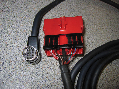

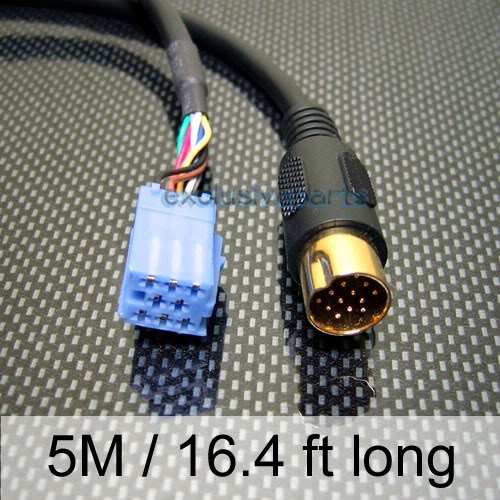

I can't tell much about the lead in the bag, but it has a blue connector.
The lead with the close-up appears to have the correct round connector, but the blue connetor will not fit the socket under your seat. Maybe it would plug directly into the head unit.
If you are prepared to cut and solder the wires under the seat, then there is a pretty good chance it would work.

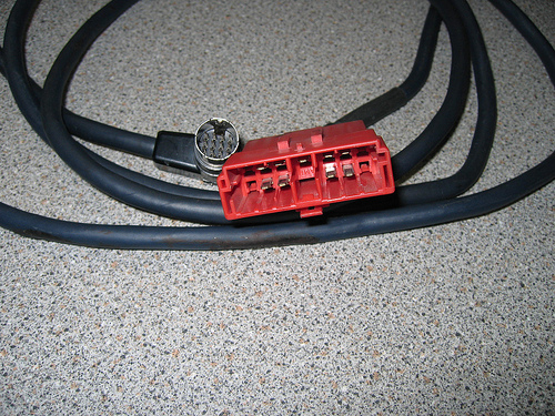

Now thats just making me jealous no chance you could lose it in my directionDickieG wrote:Here's a couple of photo's of the genuine lead;
Have had a look at the wiring diagram for the OEM plug to 13 Pin connection and it appears that pins 3 and 7 of the OEM plug connect to Pin 2 of the 13 Pin lead so may end up with an 8 pin plug as detailed in this PDF Link
So my guess is this lead should be the one i need to mutilate
Cheers
Colin

I found the piece of paper where I recorded the connections about 8 years ago 8) .
The round connector has the pin numbers embossed on it, but looking at the pins of the plug, with the key notch at the top, the pins are numbered:
1 2 3 4
5 6 7 8
9 10 11 12
13
and the rectangular connector has 2 rows of pins labelled 1A-7A and 1B-7B, looking at the pins on the chager cable (or the back of the connector on the car):
-- 2A 3A -- 5A 6A --
-- 2B 3B 4B 5B 6B--
The offset key is at the "1" end
The connections are: "round connector number" - "changer cable clour" - "rectangular connector number" - "car wiring colour"
1 - NC
2 - Brown - 5A - (Green)
3 - Red - 2B - (Orange)
4 - Green - 3B - (Yellow)
5 - NC
6 - (audio ground) - 6B - (Black 2way + Black 2way)
7 - NC
8 - Red (audio) - 5B - (Green/White stripe 2way)
9 - NC
10 - Blue - 2A - (Red 3way)
11 - NC
12 - Grey (audio) 6A - (Green 2way)
13 - Pink - 3A - (Green 3way)
Shield - 4A - (Black 3way)
1 2 3 4
5 6 7 8
9 10 11 12
13
-- 2B 3B 4B 5B 6B--
1 - NC
5 - NC
7 - NC
9 - NC
11 - NC
