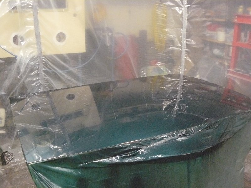

As for using an air fed, not when your outside
I use 2k all the time, have done for over 10 years just dont abuse it.
This is what i get working outside, straight out the gun with a 2 stage clear over base finish. Its a german made lacquer which is voc compliant and scratch resistant.
