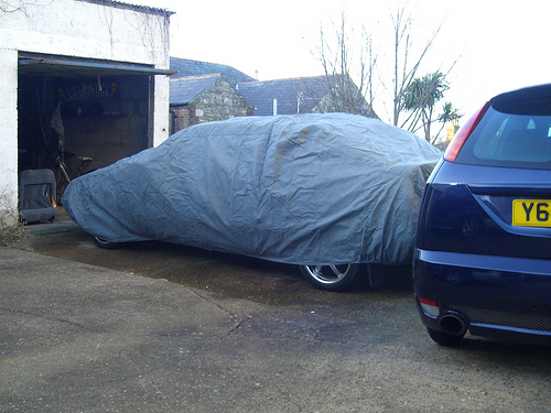

Does your car cover look like this?
cant see the cover is the problem, or the autoglym, ive been using it for 6 years on the XM and it is brilliant, your activa is the metalic though and a lot of early met's suffered with the laquer de-laminating and pealing, it usualy happens on the more sun exposed panels like the roof and bonnet too
D

Im not sure why a car cover would have caused that problem.
Depending on the covers, if its not a breatable one then the car can sweat and cause condensation.
We have 3 car covers, one is very old now and was used for the Xm. It is breathable though and did its job of keeping water off the car, out of the doors, any places rain water could settle etc. It did make the paintwork a bit dull over time, but that was the only effect and it soon polished back up fine.
The Xm has a new cover now, which is a tailoured fit cover, made just for the Xm, its breathable, lets out any moisture and has a nice soft lining. I doubt if this cover was designed for the Xm to sit in low though, as when its resting in low the covers is about 2mm from the floor. A good thing really. Being fitted to the cars shape it fits snug, so doesnt flap around in the wind and buff up the paint, as can happen on non fitted covers. The van also has this type of cover too.
Neither one of these covers have effected the paint of the cars in any way. The non fitted one didnt either. They can dull the paint due to the constant touching of the fabric, but it takes nothing to polish the paint back to shiny again. Although to minimise this always make sure the car is spotless, freshly dusted before covered over and the inside of the covers is as clean as it can be too.
Seems like the cover you have might have had an effect with the laquer.
