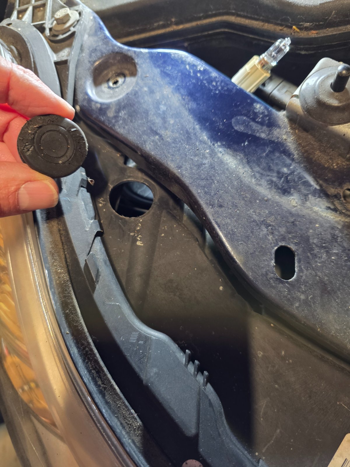

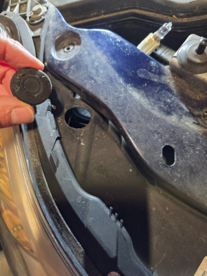

I have just managed to replace the right hand side light bulb without removing the headlight (April 2006 car). There is the grommet on the rear face of the light unit but also one in the top surface that I haven't found mentioned anywhere else. With the poor access I think it would be impossible to do with only the rear access grommet but removing the little one in the top surface allows you to see what you are doing and to get a finger from a second hand on the job.
Perhaps they added this on later non-zenon lights.
Photo attached.

Looks like a handy hint for people. Thanks for posting!
