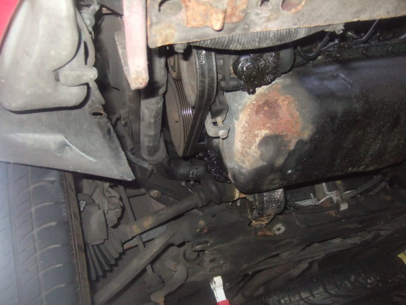

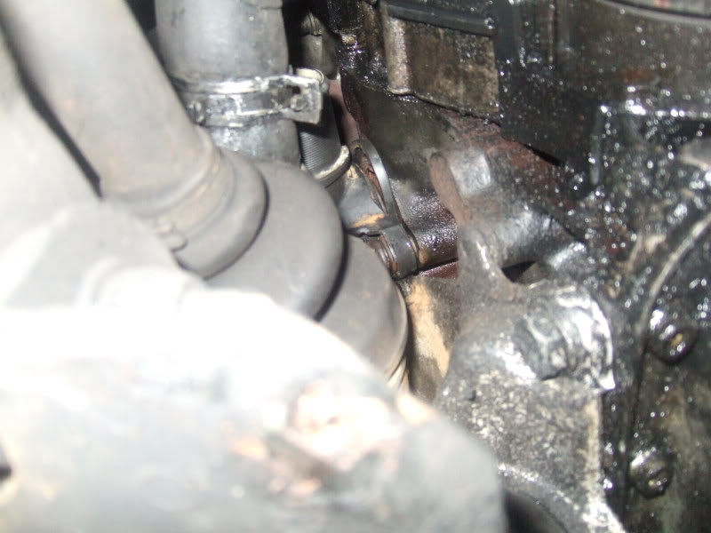

Well i've just been out under the car to fix that leak and the rubber gasket/grommet/rubber ring is too big. having pulled a hose off to examine the junction and i can see how the ring slots in to make fitting easier and no fiddling at the hard to reach side, however the ring that I have now and the one before are too big. Tried squeezing it in but too much to go round so surely wrong size. hmm :?:
Oh and the battery is flat now.
:roll:
