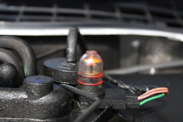

My gauge doesn't seem to be working on the LHM tank, is there a way of changing it ?.

citronut
Posts: 10937
Joined: 29 Apr 2005, 00:46
x 94
Unread post by citronut »
why do you think/feel its not working,
all the years i have worked on and around citroens i have never seen one which realy is stuck
if it appears to be stuck right at the top, the most likely fault is the tank is very over full, the way these floats work IMO it is impossible for the not to opperate corectly,
but if you feel the urge to lift it out to look see, the pull the two wires off the rotate the hole thing about i third of a turn and just lift it out
regards malcolm

Hi Malcolm
The reason i ask is..If i put the car on full height or to the lowest setting the disk does not move. Perhaps i am thinking it should when it shouldnt..
On checking the LHM level it seems to be about half way when on full height is this correct..?

citronut
Posts: 10937
x 94
the yellow/orange and the lower copper disc's move up or down together, as they are both fitted onto the same plastic shaft/spindle, which in turn is one piece molded to the float bulb,
so were dose your yellow/orange disc (topermost disc) sit in the clear dome, regardless of were the fluid looks like it is through the top of the tank,
on high and or on low susp setting's
regards malcolm

Obviously not tonight but i will take a photo of it..I am really new to this Citroen thing but enjoying it so far.. :D

Photo as promised..It does not move between the lower and higher settings..
Just took the gauge out and it all moves perfect..Is it overfilled do you think..

Posts: 28584
x 5622
The obvious solution would be that the reservoir is overfilled. Can you bleed some LHM out of the system and see if the indicator falls? Bleed a litre off the brakes is probably the simplest way - observe the usual precautions for hydropneumatic cars.
Failing that it may have suffered mechanical damage at the hands of a bodger and need replacing. Should be plenty around in scrapyards.
It is very messy which could be a side effect of being overfilled. More isn't always better :evil:
