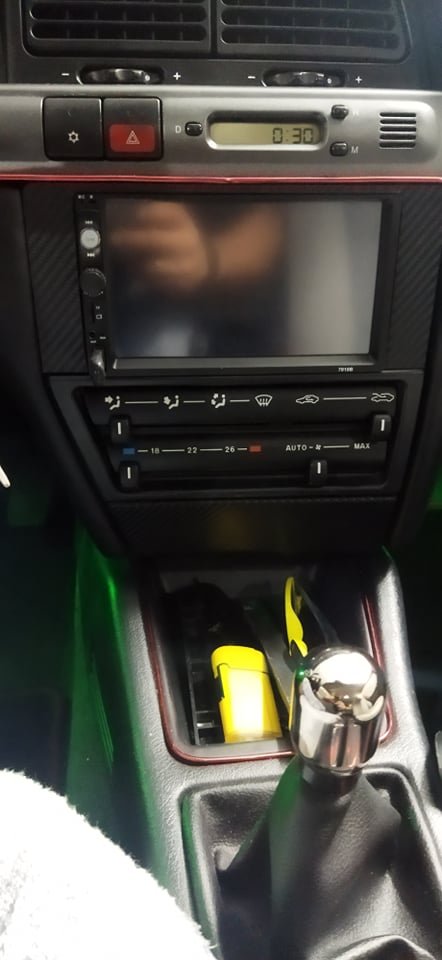

I have installed an aftermarket Radio-Usb-Touchscreen in my Xantia. It looks very nice, and it's practical. It's one of these chinese radios (7010b) that they have into the rear voltage plug, one pin that is for the steering wheel controls that might have tha car that it will be installed to. The unit, has a firmware that can "learn" the functions of every existing button (It's programmable) ....So.... I was wondering.....If the cables that come from my steering wheel are +12v, ground and command.....and the connection is between the ground and the command ..... if I find which one is the ground line (and connect it to the chassis) and which one is the command line....(and connect it to the aftermarket radio's steering wheel control pin) I might have somekind of signal to this pin , and I might be able to program the buttons for this unit..... Maybe , tomorrow , I 'll try it.....

Hello again my fellow frenchlovers. I've replaced my multimedia player again , with an android one. It works perfectly. And, it has steering wheel controls programmable feature. So, I was wondering if someone could reupload the schematics for the x2 series, the one with 3 cables, also if someone could upload another one with the pinouts for the brown plug that stands for the steering wheel controls. If someone could help I want to try connect it to the android , and try to program the steering controls. Thank you in advance!
