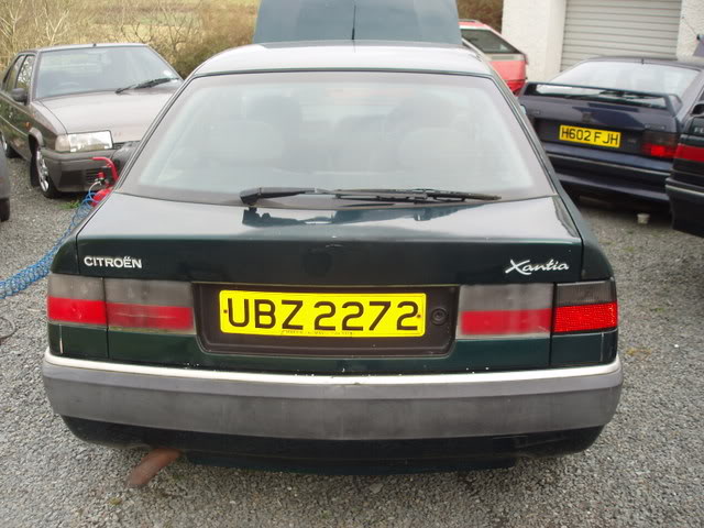

finally got pictures uploaded still happy enough with the car
the list of to do so far is
replace the drivers side window motor
fix rear suspension near certain its is the linkages as front will go up and down with no problem
full servce
tacho is very erratic cuold just be a dirty sensor
half the dasboard lights do not work
abs light on permanently

Nice little collection you have there!
Isn't there something else missing from that second picture :lol:

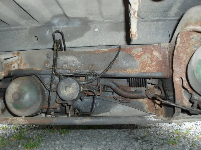

Image Image
Image Image
I can't believe that underbody corrosion! Salt is an evil thing...

addo wrote: I can't believe that underbody corrosion! Salt is an evil thing...
By Pom standards Adam, that's not bad corrosion at all...
I've just had my old 16 year old 1.9TD MOT'd (Certificate of Roadworthyness) and the tester made a comment that the underneath was "Rusty and Weak". It's not but it does look very similar to Robyn's above..
But yes, salt is an evil thing :evil:

Judging by your picture of the underneath, those spheres hardly look new and could be in need of replacement.

agreed but even with duff speres you should get full travel on the suspension looking forward to getting stuck in next week ,the rest of this week is spent on a garage makeover as there is not even enough room to put a cup of coffee on the workbench never mind doing any work!

Keith J wrote:Judging by your picture of the underneath, those spheres hardly look new and could be in need of replacement.
The outside condition of rear spheres are very misleading. I replaced my rears about 9 months ago and it looks more like 9 years :twisted:
The only sure fire way is to either take a ride in another Xantia and compare, or get the spheres pressure tested.
