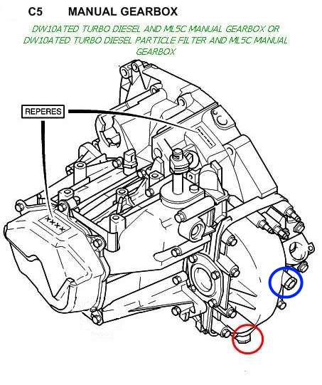

Hi axford, In case you don't have the chance to get/add a picture I have a C5 gearbox picture here.
Using Xantia gearbox as a reference I have added two colored circles.
Gearbox oil filling hole would be the one which is marked with BLUE color and the draining with RED color.

OK, axford I hope there is no serious damage (Wifes are usually right :) ). Do you know the gear box type? The picture I have added was type ML5C.
Anyway gearboxes are similar and the idea is almost same.
Here is a photo of a BE3 type (Xantia) while adding gearbox oil, filling hose still attached. 1.8 liters goes there.
I have added the same colored circles here.
I hope someone will be able to help.

the drain plug marked in the picy is only the drain for the diff, there will also be a plug under the gear box its self,
in the second picy that plug is the level plug, which is ok to fill through, but i always fill through the vent plug on top of the gear box, this is a 17mm plastic plug right on top of the gear box,
if you try filling through the speedo point you might not get much or any up into the gear box proper,
as when filling a gear box with oil it fills the the level ledge in the main box the overflows down into the diff,
