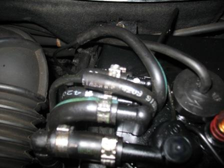

One small problem ...I have a tiny pipe no more than 3mm in diameter that seems to have popped out from somewhere near the reservoir, and I can't see where it's come from. If anyone has any ideas, I'd be very pleased to hear from you.
I've got a photo if I can work out how to post it!! OK a bit amatuerish but you can see my little lost pipe bottom left. Any ideas please? Its puzzled me.
I've re-fitted the new (proper) spheres and am cleaning out the reservoir and putting it all back together

P.S. Looks like a return pipe but where the hell it goes is beyond me, ages since the Xantia went to motor car heaven.

If you give me a few moments to let a shower pass, I'll go have a look at my MK2 and see if I can see the pipe in question and I'll take a photo.
My guess right now is the pipe is the Brake Dosuer leakage return that comes across the bulkhead.
Be with you in a bit...

Just to see if it will work, Nobby's photo.

Thats the one Jim!!!!!
Funny that such a tiny bore pipe goes into such a big one, but thats it. Located, fixed back in and just belted up the A4081 and back and it all seems to be working a treat!
Citrojim, myglaren and andmcit thanks so much, I would never have managed it without you
